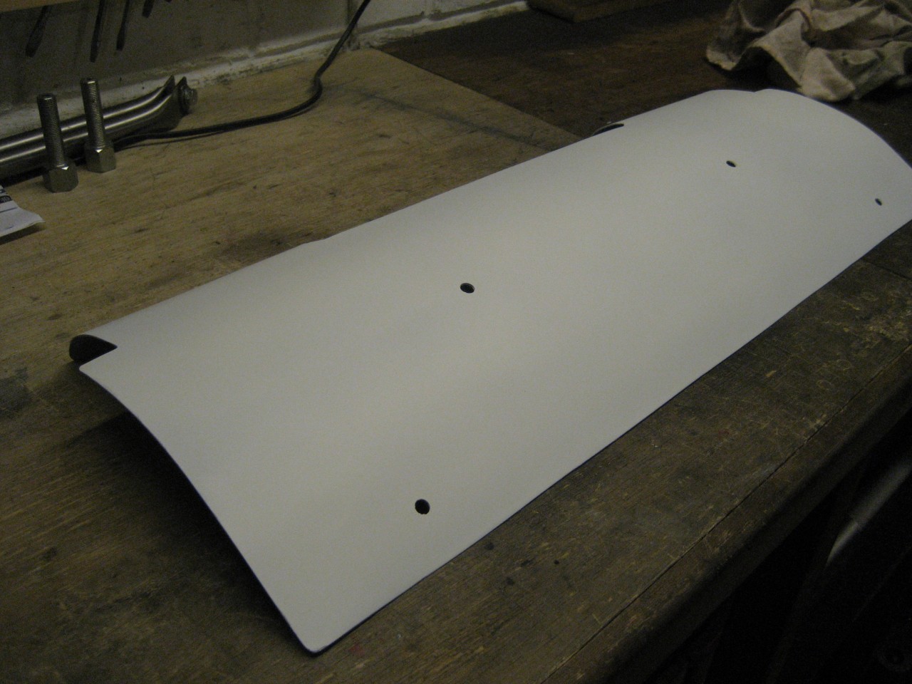

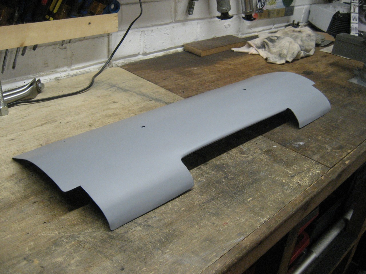

First the front cowl..........primed. I managed to delete the photo with it in bare alloy. Grr.
I decided to go with 1.2mm to make the bending easier, so I turned over the lip to give it strength.

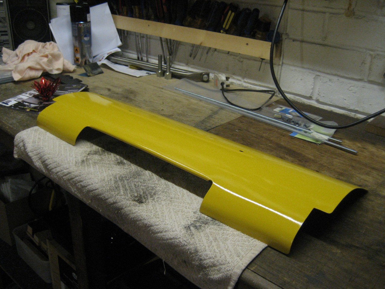

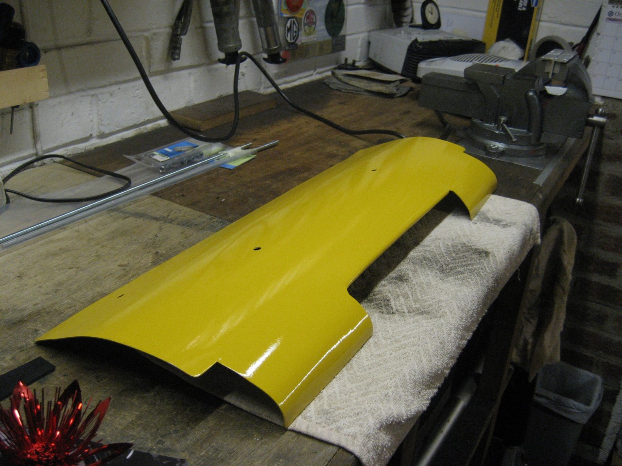

Painted.

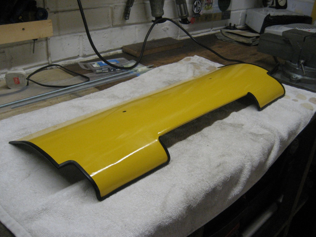

Edged with u channel neoprene.

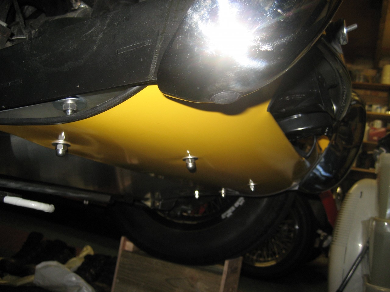

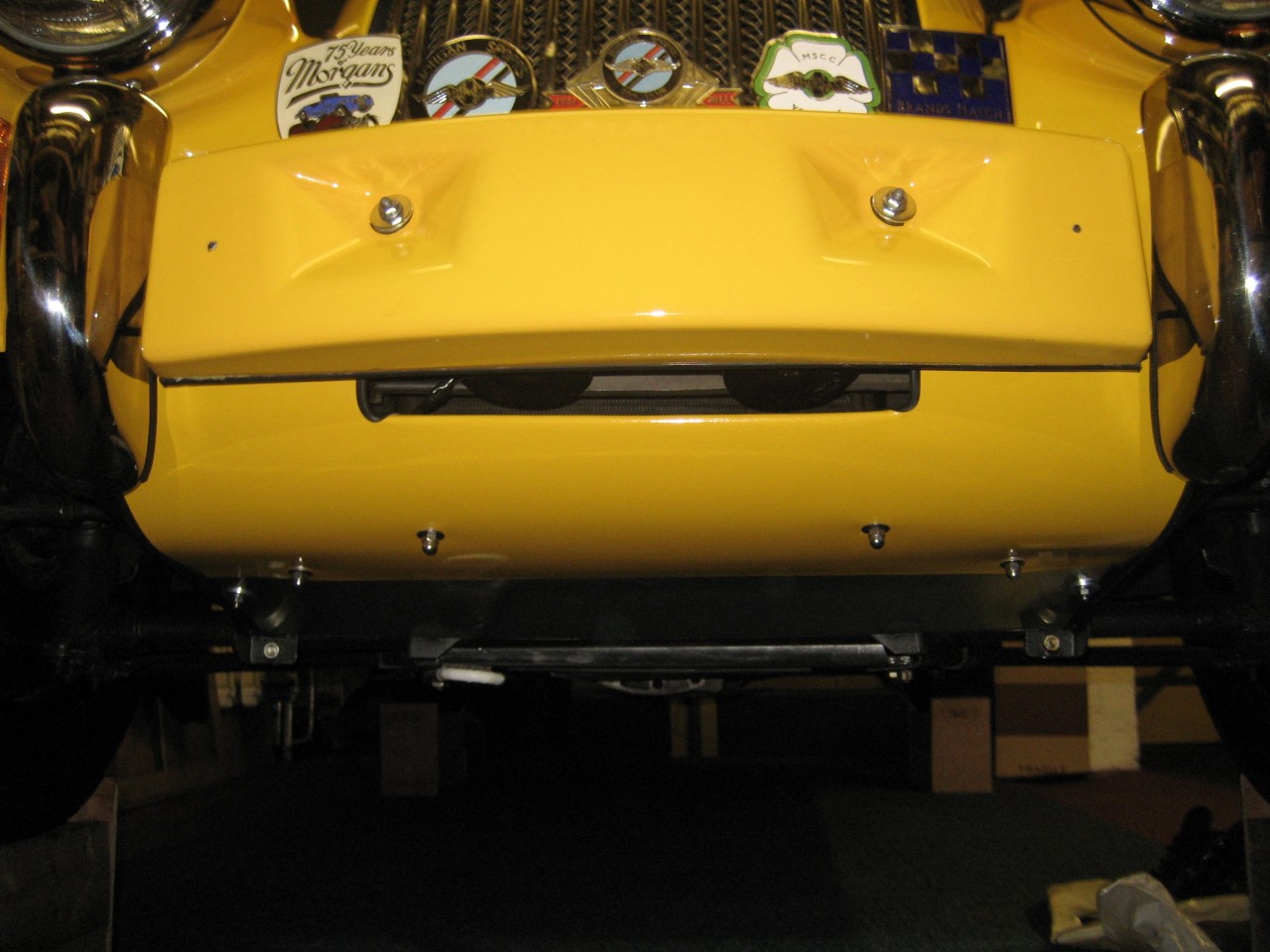

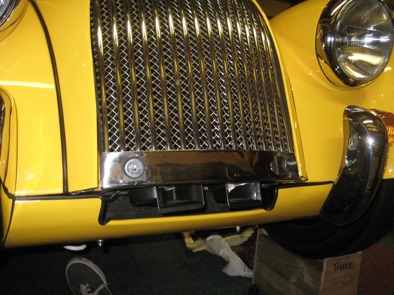

Test fitted:
