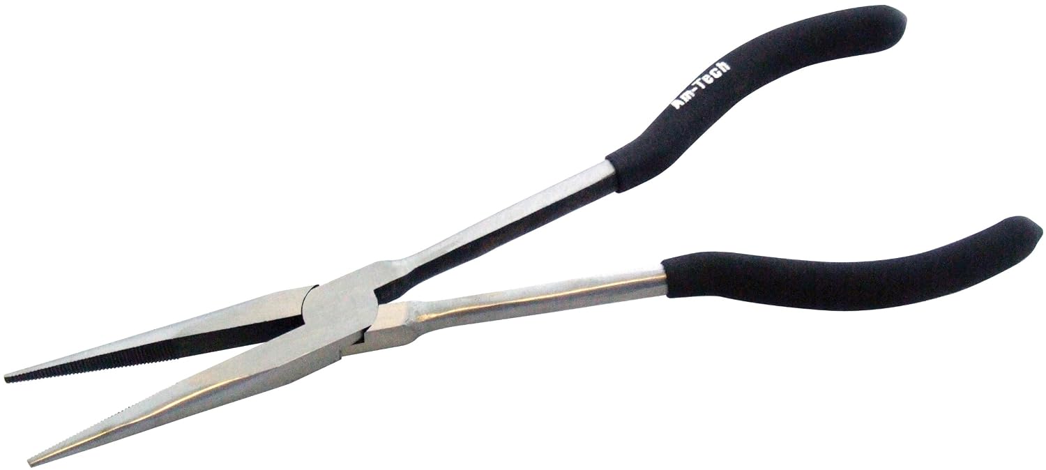

That's the way I do it too. One tip I got from Kevin Vernon is to use long nose pliers like these to do up the castellated nut, that way you don't put too much torque on to it. Once it's just snug, you then back off until you get the first line up between hole and castellation. As Dave says, better a smidgeon too slack than too tight.
