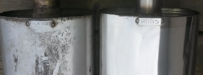

Stupid question time...........
How do you know if your car is fitted with a sports exhaust or a standard exhaust?
idea
On the factory silencer box there is a little welded plate with MEX1107 or MEX1105 stamped on. MEX1107 is the straight through noisy one.
