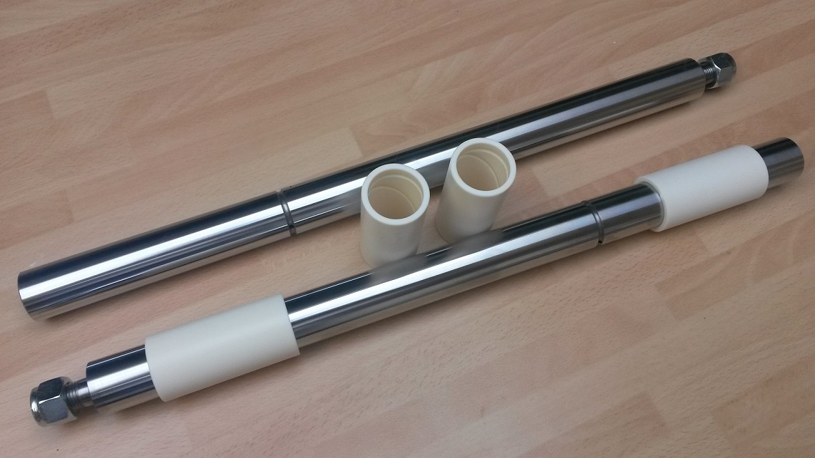

I had a plan to replace the Devols in my previous car with these Hilube Vesconites and hard chrome pins. However when I sold the car at 25k miles the Devols were still passing the MOT so never got to fit them. With their super low COF I was hoping for a ride improvement as well as extended life.

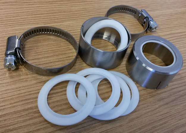

I had also planned to give these PTFE wipers a whirl. They attach to the lower stub tubes above the bottom spring in an attempt to keep the muck out.
