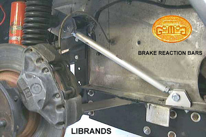

Below is what racers and some moggers used to (and many still) use as brake reaction bars.Can you estimate whether THEY will affect the absorption of force in a
frontal trad impact at speed? Do you think they might inhibit absorption?

![[Linked Image]](http:/www.gomog.com/TEMP/Wells~BourneBrakeReactionBars.jpg)
