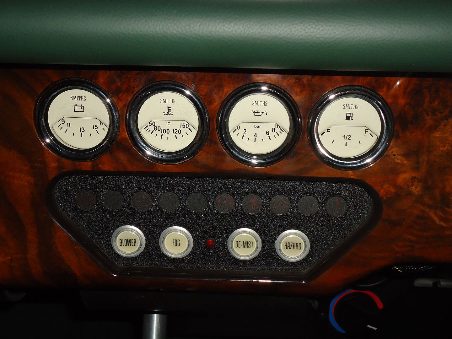

Hi Daniel
No I don’t think it is what you are quoting. They are the round 25mm diameter type (61-9642.7).
You can find them on this page:
http://www.eao.com/global/en/Catalogues/...1-Full-Data.pdf
They can also be sourced from Farnell & RS.
PM an email address and I will forward the artwork.

Hi Rog, very nice and simple conversion, is that 2nd photo your artwork? Do you print with an inkjet or colour laser? I'll send a PM - I rather like the black background and clear logo.
You mention coloured LEDs for the switches. Are they already fitted with coloured LEDs or just plain "white" bulbs? If so have you replaced with coloured so that your plain inserts illuminate in colour, or just white?
Perhaps you have a photo of them illuminated?

Hi Nigel
The 2nd photo is a Word document with 8 variations of the artwork file dropped in for printing. The group of 12 clear switch legends is the generic artwork. Use MS Paint to colour in the generic artwork, will send both files. Inkjet or laser for paper, but laser for film.
I have 3 white leds and 1 red led for hazard switch as standard. I may change all leds to green or white but I still can’t decide which legends to use yet!
Photo below as requested but I don’t think my photography is that good. They are more readable in real life. Also printing on white paper rather than film does dim them.
Roger
They work well in the dark. Nice one.
