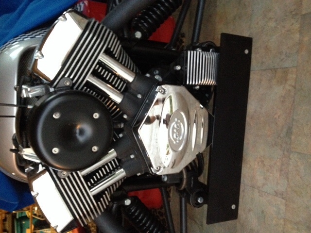

Do you have a photo ?
It seems to be good voltage on run is 14,5 / 14,6 v
Sounds good. Any photos?

Heres a couple pics. Sorry they're sideways

Good job.

Looks really good,but wont it rust or turn a bit brown? Because there is no seal on the metal?

It's a cast aluminum housing so no rust issues. Aluminum sheds heat more efficiently that steel

Aha,looks very nice
Very smart indeed.
