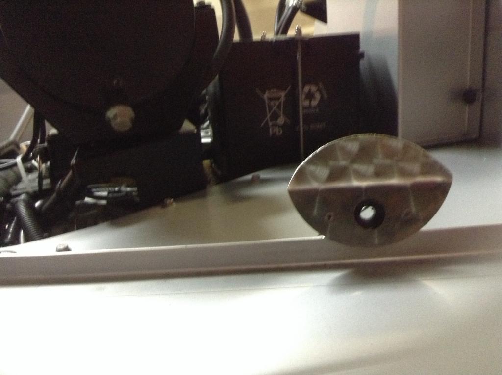

The same idea to take in hairdresser accesory

I have removed the circlips from the inside of the front 2 dzus clips, making them removable, this enables you to see through the hole in the bonnet to line it up with the female part or the clip in the body.

i try the second
but the clip jump
first proposition is good i use it since i ve my superdry

As an alternative to atalante's plastic tubing I've tried clothes pegs to hold the fasteners out for refitting. It helps but is still not easy.

Little upgraded
