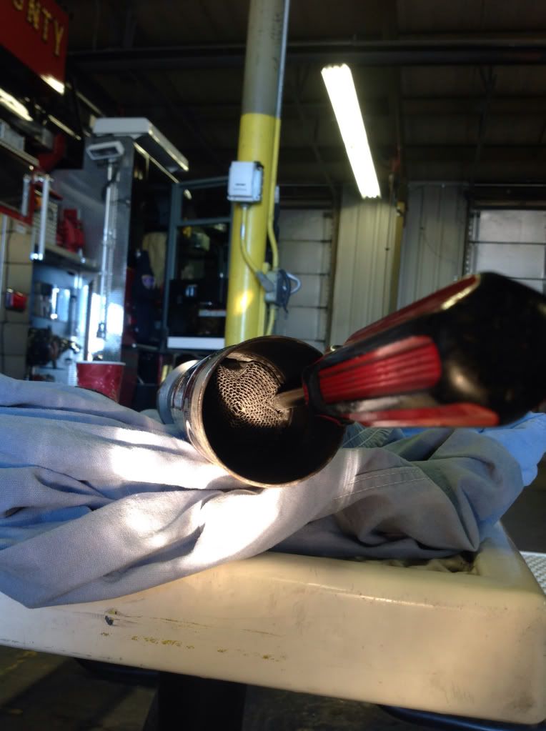

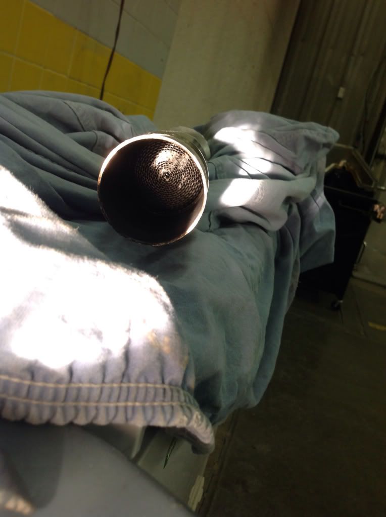

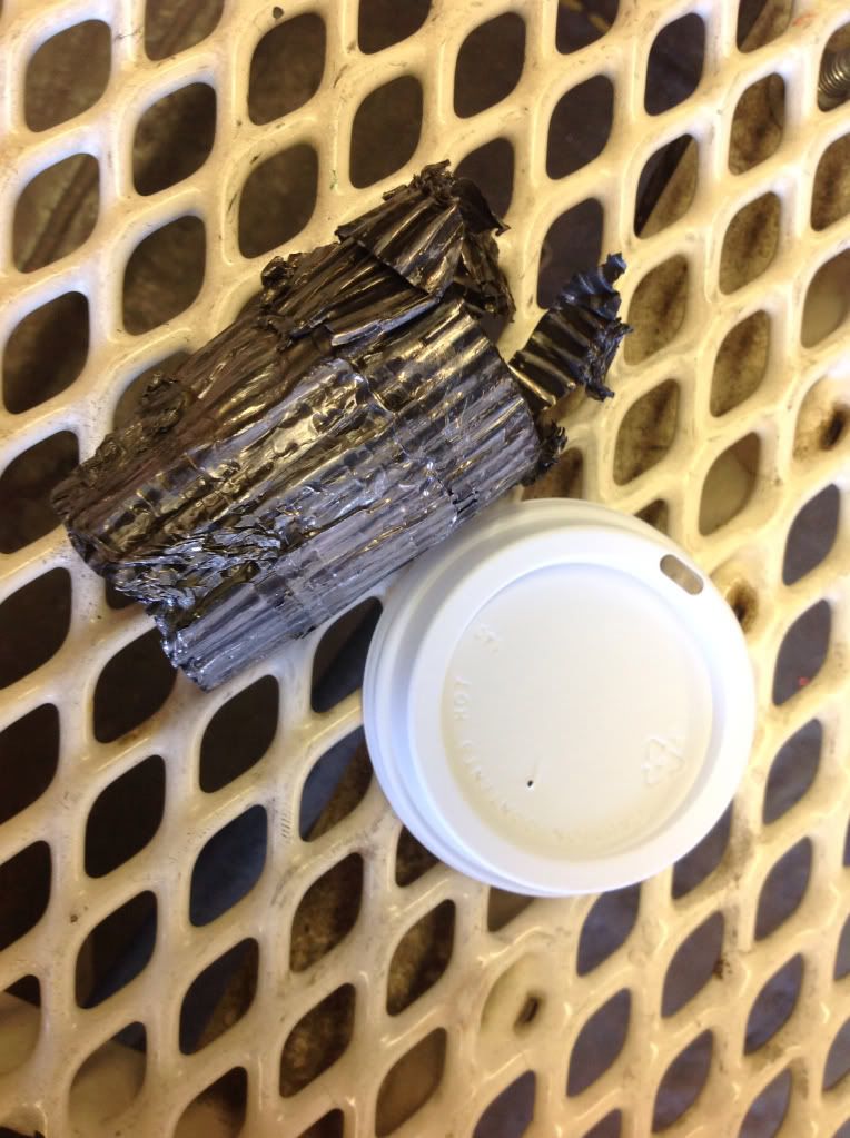

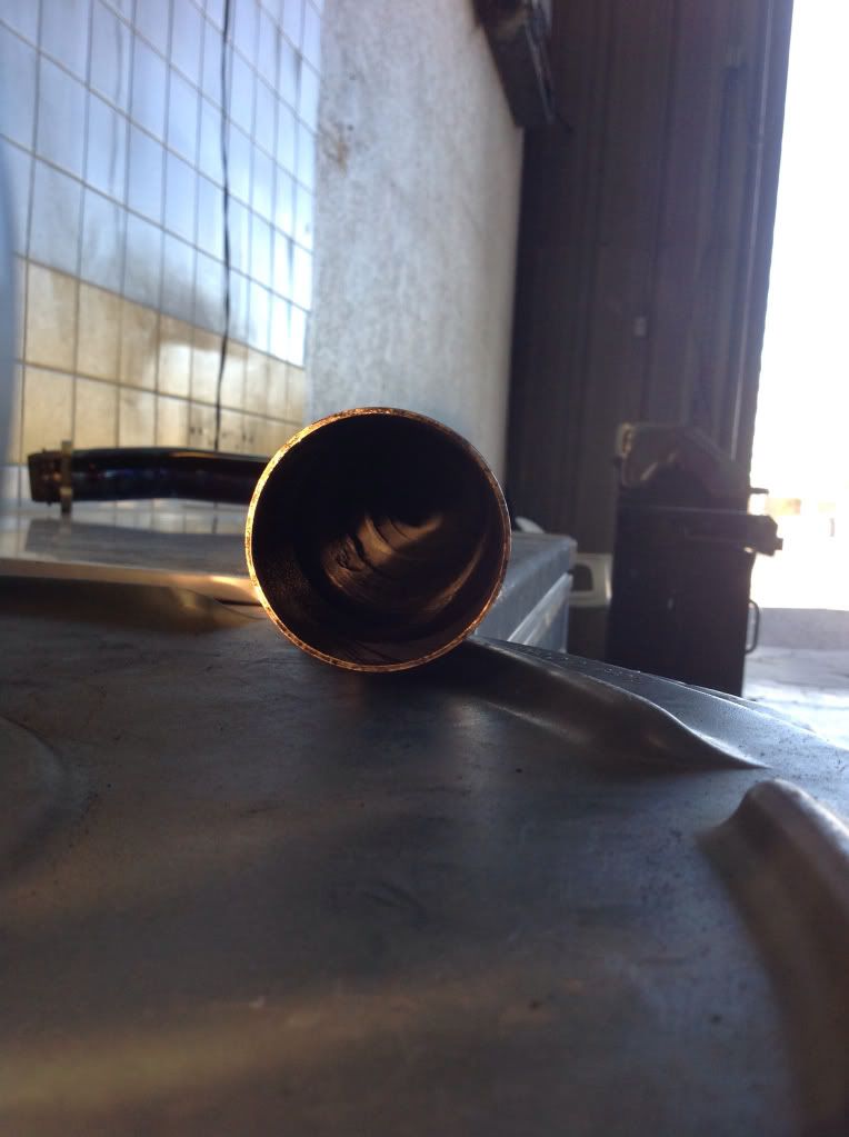

Not sure why there are Cats on the M3W in the first place, other than US spec models needing to meet The Republic of California's regulations for import, so I'm taking the plunge and removing mine. Fairly quick job with a rubber mallet and a long flat screw driver. I drove the screw driver blade all around the outer edge of the honeycomb material until if felt loose within the chamber. From there, it is a simple, but slightly tedious job of fishing the honey comb plug out. A few more minutes of scraping the inside wall free of left over bits, and bobs your uncle.
I'm at work today, so I'll have to report back tomorrow how it sounds and feels back on the car. I'm hoping for a gain of a more horses and at least a few decibels. Fingers crossed

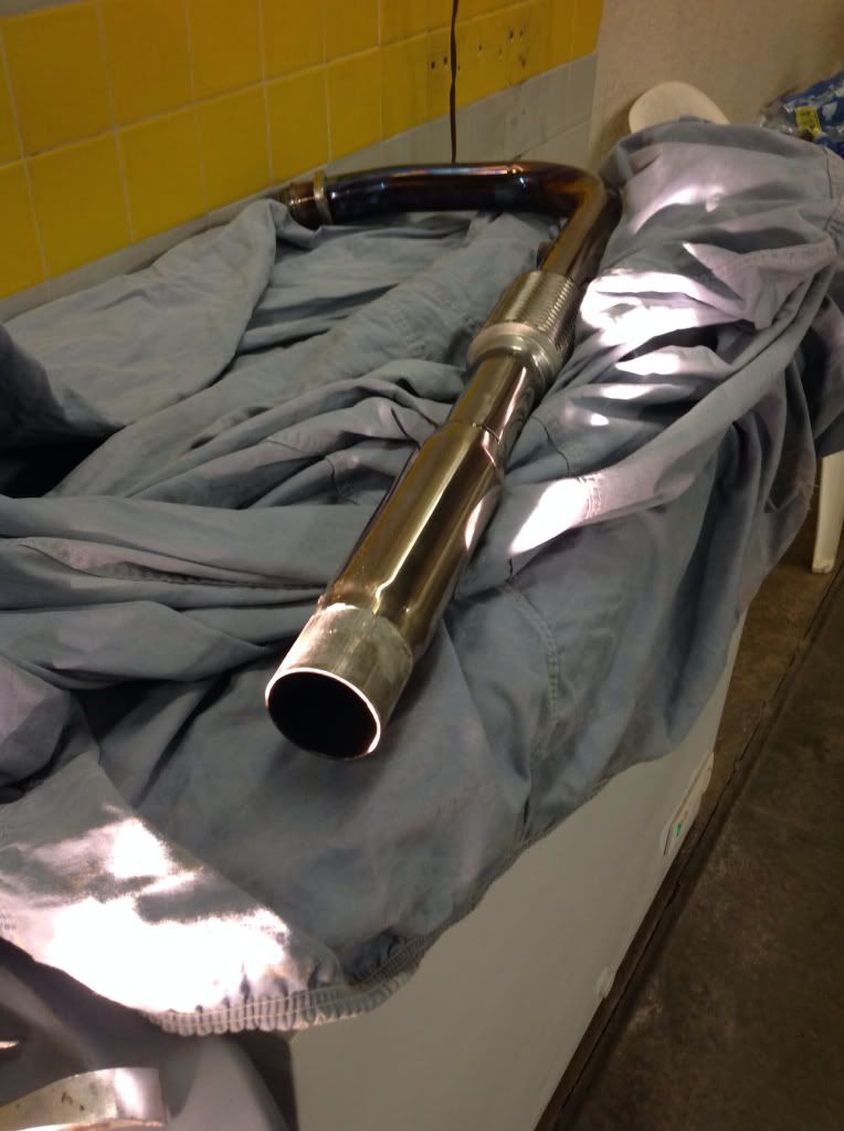

This should be interesting ... I don't think you'll see much in the way of an HP increase, I don't the cats are that restrictive. Might be a slight TQ decrease. As a rule of thumb, Harley's like a straight pipe with a 1 7/8" ID with a length of 42-44", for the street. You need a little restriction or TQ fall off the map. Actually, given piston diameter and stroke, a (single) Harley cylinder is very similar to a (single) SB chevy cylinder. The S&S has a bit more displacement and the M3W pipes are definitely longer ... did you check what the ID of the pipes is ? From the pictures, the pipes look 'chambered'. S$S designed the exhaust, the mufflers are basically straight through 'glasspacks'. It's designed for max performance, as is. I think S&S R&D rewrote the book ... unless they share some of their secrets, it's going to be trial and error.

Yeah, I'm not expecting too much in HP gain if any, and I definitely hope to not see any decrease in HP or torque. My feeling is, yes the restriction, at lease while still new, isn't much at all, and because of this I don't see much if any back pressure created by the 3" long cat (there is only half the length of medium of the cat chamber with in it).
If anything, I'm hoping for a bit more sound out the tail pipe with out having to modifying the muffler.
I don't believe there is any chambering with in the pipe, i think what you are seeing inside are welds, otherwise it's smooth in there. The ID at the end of the cat chamber is 2.25" and from the header from the engine back to the beginning of the cat chamber appears to be darn close to 1 7/8" like you mentioned. The rest of the exhaust is not with me at the moment, so I can't comment on that.
I'll get it back on in the morning when I get home from work and go for a spin and see what I've got.
