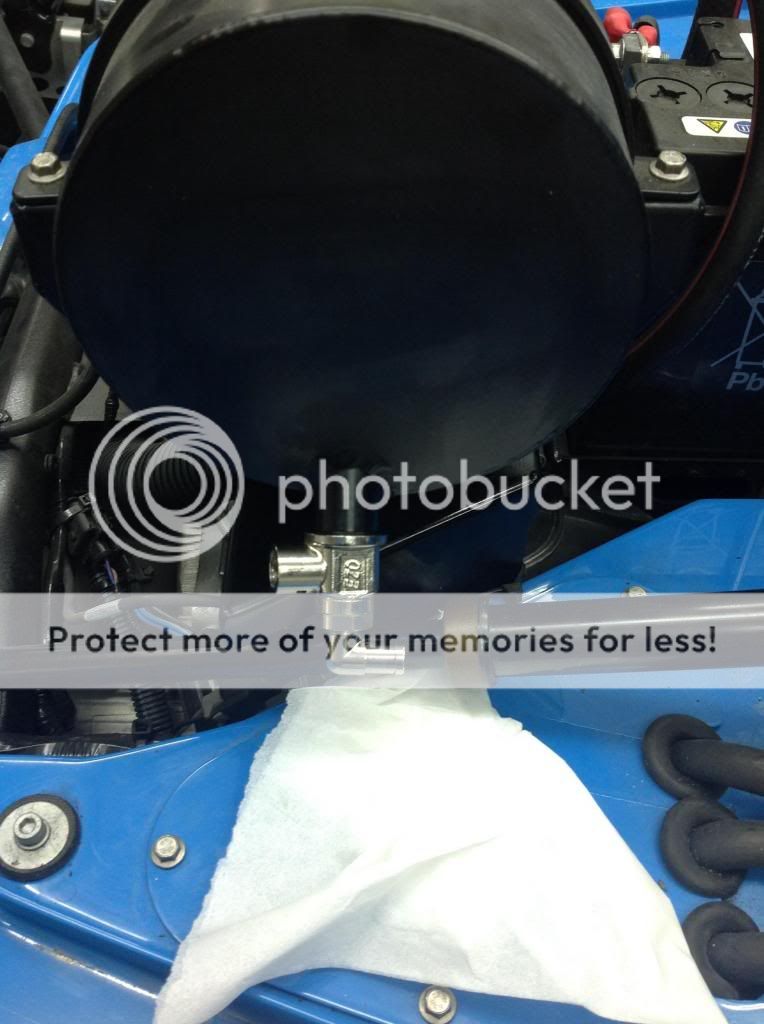

Ez oil drain
Part #ez-107
Thread size 12mm-1.75
Works like a charm

But i couldnt center the valve straight,the level is on the left a bit

The lever i meant
Q8morgan #186568 16/03/14 12:52 AM
So the thread mystery is solved! Looks good.

Haha yes solved at last 12mm 1.75

I really recommend the ez oil drain valve.first i drained the oil tank and afterwards i removed the oil filter thinking i will flush much more oil out,but that wasn't the case.of course there is going to be some oil in the engine but not as much as you suspect.

I used the factory washer between the oil tank & oil drain valve & now its centered & looks much better
