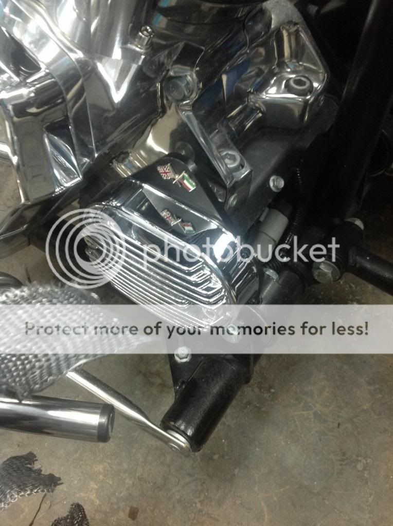

Install it directley on the plate..i will post pics soon..wiring fits directly with no issuses

I used exhaust heat wrap between it & the plate.fits directly into the holes without using the bobbins that wear out really fast.now its been working for a few monthes perfectly without any issues,i have the gauge reading on volts all the time.and all is fine
