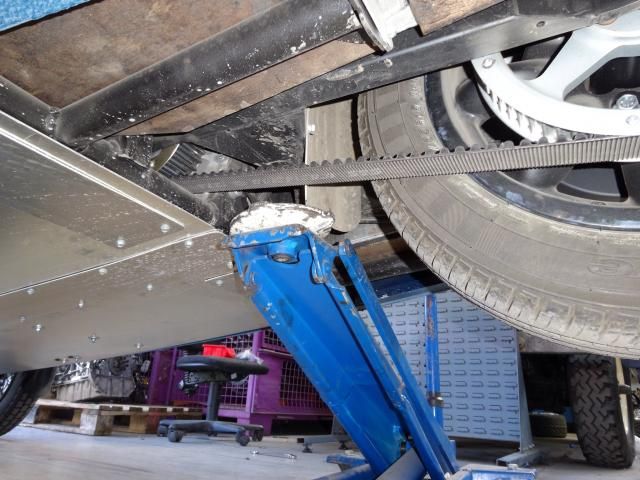

I've got some stands for the car but where do you jack it up?

This might help
The jacking point if on the chassis by the swing arm. It's not the best picture as it looks like the cars jacked up on the mud guard. If you look under the car you'll see a small slot into while the lugs on this sort of jack fit.
Once you've got it up used a couple of axle stands on the tubes left and right of the jack inning point.
