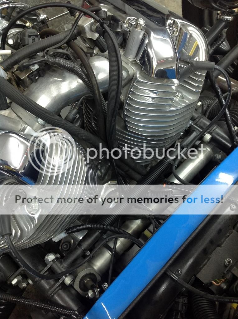

[url=[URL=http://s1349.photobucket.com/user/Q8morgan/media/imagejpg1_zps2c8a9bc6.jpg.html][/url]][/url]
Just got it...but no instructions,maybe the hardest part to install is the throttle cable

I had to remove the bar & put all the wires underneath it..took the two covers to have them resprayed gloss black,as they came black but looked bad.installed a manual switch as we cant do the ecu job here
