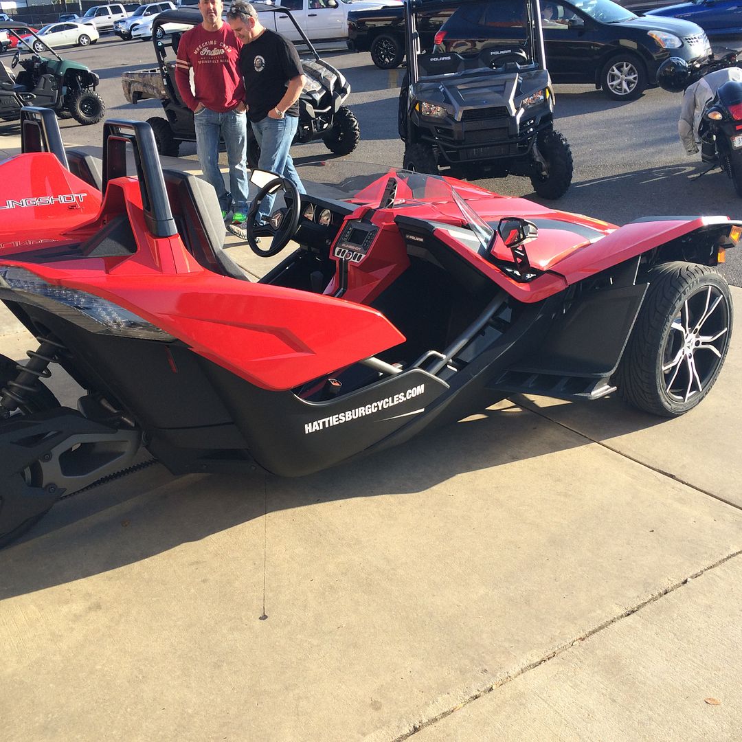

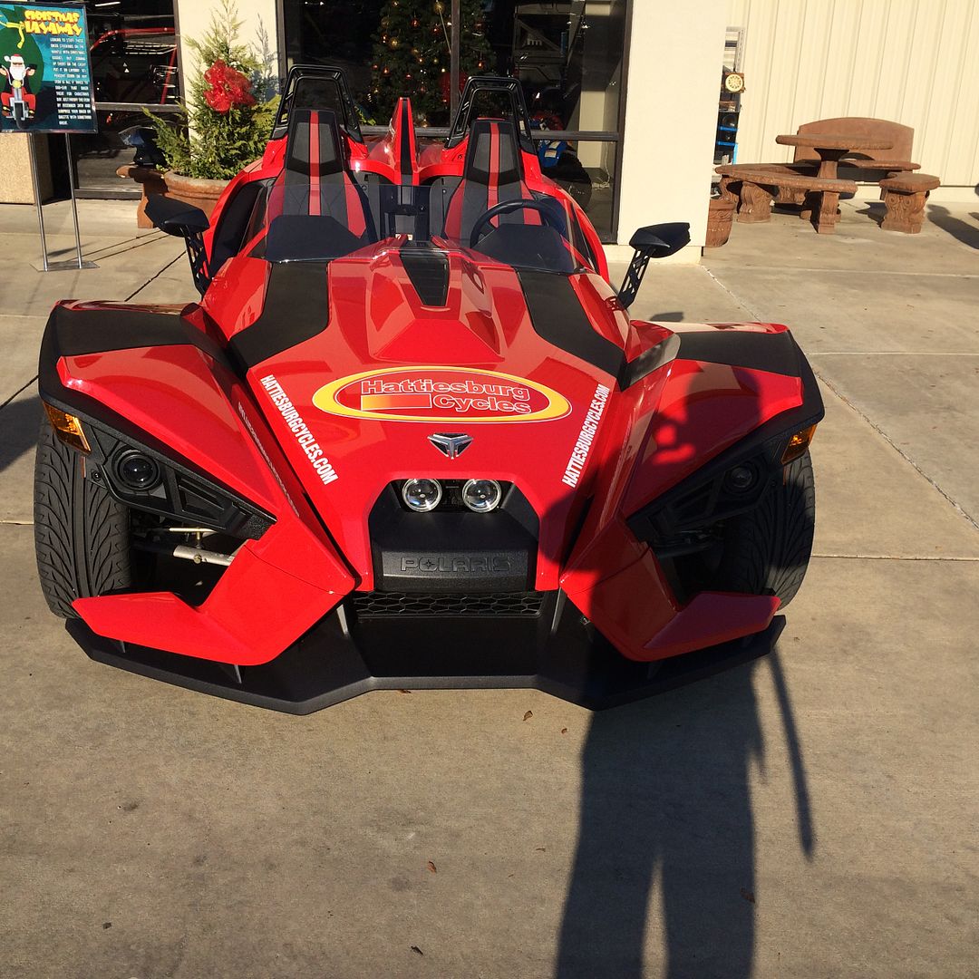

My local dealership, did, however, receive some of the SL models which have all the bells and whistles but only come in red. I ordered a base model (titanium in color) and upgraded to SL through factory options...the base models are just starting to trickle out of the plant.
At any rate, my dealer received two SL's...one went to a customer who was on the waiting list and the second was retained by the dealership as a demo model. I went by the dealership Saturday to get a status update on mine...while there, I took their demo for a ride.
I had to wait on other demo drivers to return in the 3W so I could take my turn. The Slingshot had been in use all day as lots of people are demoing them.
I'm good friends with the folks at the dealership...the fact that this is the 7th vehicle to purchase from them this year probably helps in that respect. So off I go...with the stipulation that the traction control not be turned off during the demo...of which I agreed.
At start-up, the engine sounds under-whelming due to the quite exhaust but it does run good. I drove it like it was stolen or in anger...taching it up hard in every gear. It dives into corners like a sports car...and will "drift" around conrners even when traction/stability control are activated. Brakes seem a little mushy for the first bit of travel but get better the deeper you get into them (much like the M3W). After about 25-30 minutes of abuse, we pulled back into the dealership.

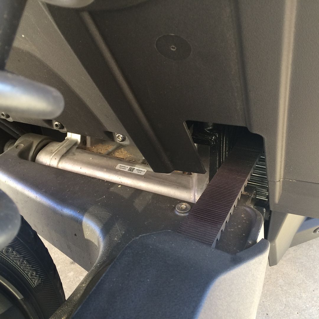

Once parked, I immediately got out and checked the temp of their "bevel box". I could lay my hand anywhere on the box and keep it there. That is not an option on my M3W bevel box...it runs 180 degrees on a good day and have seen as high as 240 degrees before flushing the goop out.
Though some of the new Slingshot owners have posted that the Slingshot bevel box makes a little whine...it is nothing in comparison to the Morgan. High temps for a right-angle gear box pulling a belt drive isn't mandatory.
Admittedly, it isn't as cool, elegant or refined (in appearance) as the M3W and it is something you can take a water hose to while cleaning the interior. It is a lot of plastic...much like the off-road side-by-sides...but mechanically, it is a hoot and closer to what a M3W should have been.

That's very interesting. In your opinion, is the temperature difference due to the internal components of the two bevel boxes or something related to installation? (The latter explanation for the Quaife box in the Morgan running hot seems improbable!)

The only thing that could make a BB run hot and noisy is friction, either in the bearings or the fit of the gears, and the fact that some are much worse than others would seem to indicate it is the way they are built and set up.
Very interesting comparison with the Slingshot BB Z, do they make their own or buy in a proprietry one?

the bevelbox polaris has twice as compared to mtw cooling surface which is partly in the open air, the housing is used to Bevel fixing the rear suspension arms, I am also not convinced that he resists with the engine s & s has a blast per motor revolution.
