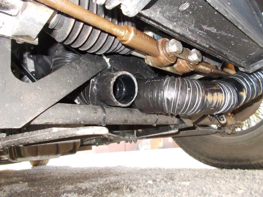

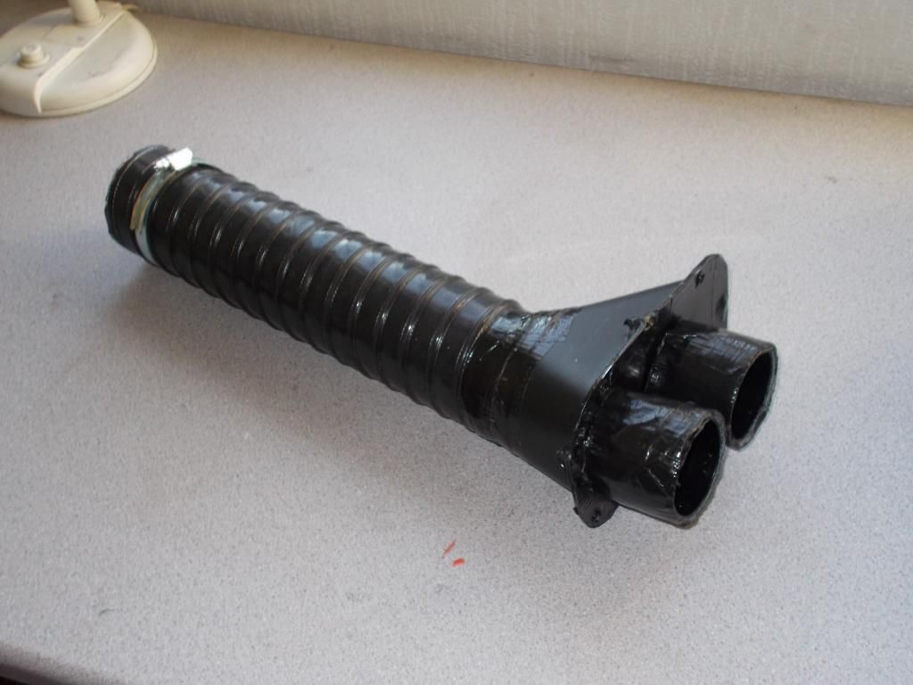

I too wanted to convert to a cold air induction system but being a Yorkshireman baulked at price of systems on offer so....
I have a Wolf performance front valance on my 2014 4/4 with brake duct inlets and thought I could make a cold air induction system using these inlets.
Fitted a KN filter in standard air box and made up the collector box and ducting below...total cost of ducting + black guttering from B+Q was 35 pounds....and it does make a difference |||

Thats very neat! I made up something similar but not as sophisticated (!) but I liked the idea of getting rid of a lot of the standard air-intake stuff. It is expensive and I will let you know how I get on.

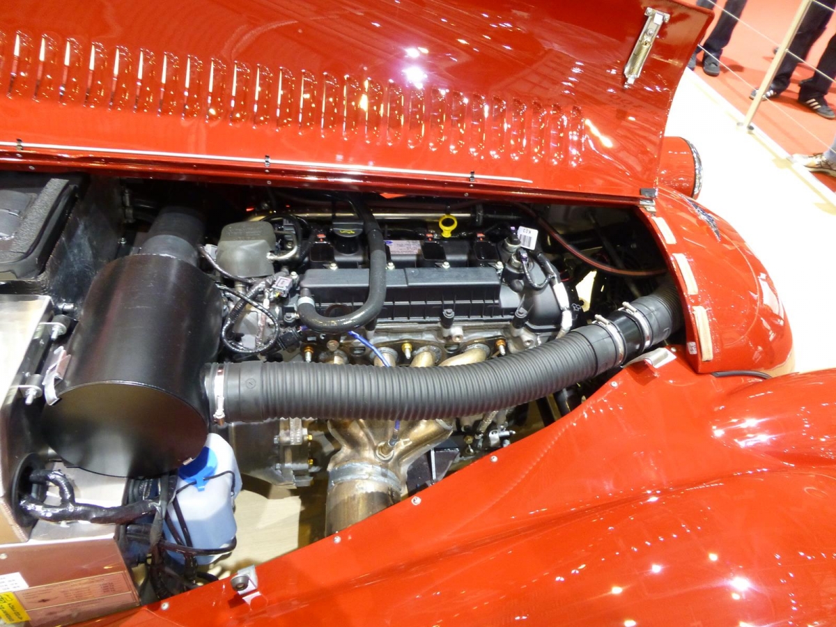

The GDI Plus 4 at Geneva last year had ducting leading over the top of the radiator. Less chance of picking up water in deep puddles or in crossing a ford.
I think I would wrap the intake tube with a heat reflecting material however.

I concur that heat shield is needed for that pipe above the manifolds.
I had to replace a similar pipe on my old 4/4 CVH as the pipe also went fairly near and above the manifold causing it to melt!
The intake was through the near side inner wing.
Also, that high position for the intake is a better one far water pick up safety.

I just don't see how a narrow long bore like that on the MMC car can be efficient, and sitting over the exhaust manifold makes it less efficient still.
