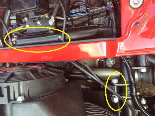

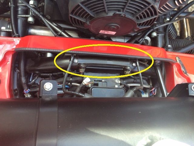

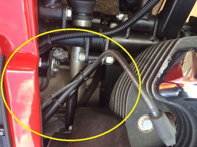

Here are some pics of the new chassis/steering mod.
Bracing strut to top of wishbone
Mounting to chassic cross brace
Cross brace and strut to wishbone mounting

Good photos, it looks like the original bolt in cross brace would not work with the cooling kit as it would foul the fan.

The original bolt in cross brace tube does clear the Urban Cooling Kit fan Dab. To me this looks more like it is a bolt in modification to give the same strengthening effect as the welded triangulation brace on the newer chassis. Easier to install as a bolt in item, rather than welding with the engine fitted. Good information and photos Chris99.
