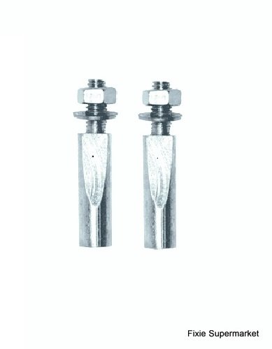

American English seems to have taken over here, but to me, cotter pins are the tapered pins one used to find on bicycles holding the cranks on.

yes I call 'em split pins too...Cotters are crank pins
Comme ça
Also cotter pins are used to locate the brake pedal to the cross shaft on early Land Rovers, just a bit of useless information!
