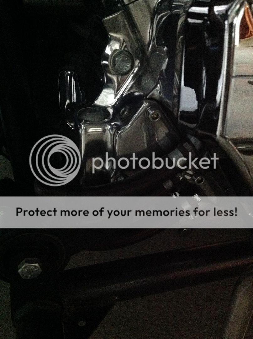

Tighten them abit more.. It might be from the plate just behind the hoses, with the 3 alen bolts. I had a little leak from it, but after tighten it all is good.

[url=[URL=http://s1349.photobucket.com/user/Q8morgan/media/image_zpsqlzfbnld.jpeg.html][/url]][/url]
