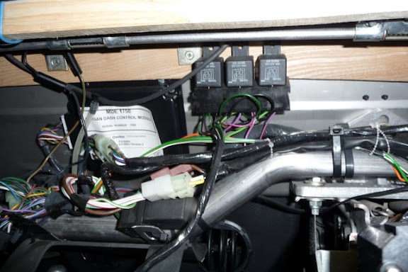

I am sure that the radiator fan isn't kicking in. Went for a run today and obviously it is hot and surprisingly the fan did not kick in (130C). I am sure it has in the past and surprised me because I did not think that it actually needed it at that time.
But I have checked the fan by supplying direct power. Checked the fuse and can only think that it is now the relay..but not sure where it is. I know there are three in the bulkhead behind the dash, and three in the Fuse Box on the engine side of the bulkhead...I took these photos a while ago when I had the dash out with the idea that someone might be able to identify them for all of us...
It would be great if there was some sort of Manual to get through these minefields of fuses and relays!

Keith,
I think it's one of those behind the dash (would be in the more difficult place!). I seem to remember one (or more) Mogtalk threads (+8 related) to 'where is the fan relay'.

On the +8 its on the bulkhead under the bonnet. No idea where for others.

Spoke to Allon White they tell me the relay is the one on the right of the fuse/relay box. (Looking at bulkhead from engine bay). I have already swapped that one out so they are going to plug in the 'Magic Box' on Thursday...might be ECU or sender unit on the cylinder block (behind alternator).

NOW SOLVED!
It was the relay on the right of the fuse/relay box that I had already changed.... but of course I used a relay that I had previously swapped out when I was advised to carry spares for the Fuel Pump and Injection last year when purchasing the car.
So morale of the story......relays can even fail when there not being used!! (Probably more prone to failing then,in fact!)
