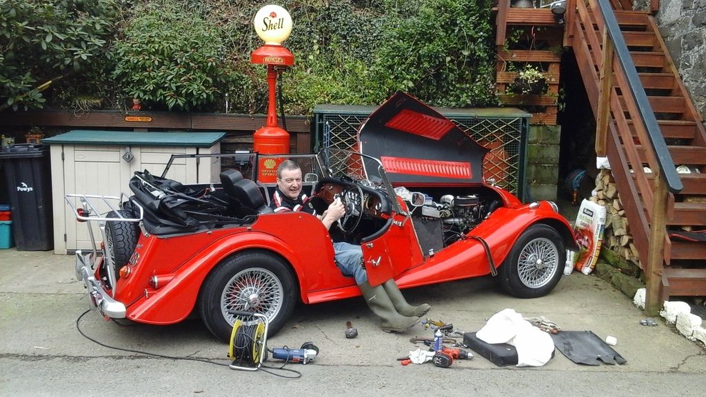

I cannot even get to the sheer bolts as they are on top of the steering column, this would involve dash board removal !
It's a straight hacksaw job through the lock mechanism plus a careful cold chisel job.
It all has to come off as the electrics insert 'exploded ' into small pieces. All the key mechanism fell to pieces so it's a full replacement job.
The jobs cancelled this weekend as the family have all decended for my 60th birthday!
Also uncle Melvin has no stock of switches and wants £98 for one ( plus vat and postage) I think a mgb one from mgbhive at £23.90 is going to be fitted !

5 hrs struggle ,speedo out and struggle as none of the wires fitted nor matched colourwise! !!!!!!
After a long struggle with a hacksaw blade I gave into a 3" anglegrinder
