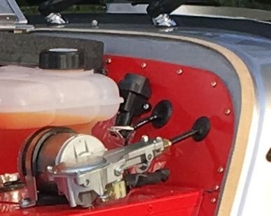

HI Laurens,
did you press the black button?
The "accident switch" could be activated after a strong ride or a "hit".
Just press it and find out if the M3W starts after it.
Sorry i have only a picture of the part from my ARP4 (my M3W is on service)
The black part with the soft surface in the middle of the picture - the same part in M3W...
Good luck - Thorsten

It's the inertia cut-off switch and on the M3W is in front of the battery on the right hand side partially under the oil tank. Press the rubber top and if you hear and feel a click that's probably the issue.
