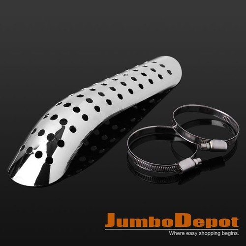

I've fitted eBay item
201444168731

Do you have any pictures of that heat shield fitted? Did you have issues with melting before you put it on?
201444168731

Thanks for the link two on the way 😊

The EXHAUST HEAT SHIELDS LOOK GREAT. DO THEY FIT PERFECTLY? I would love to order a pair
Here you go

Sold i think juggle . I will give them a try
