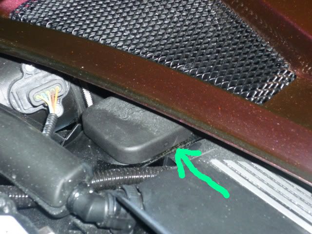

Roberts spot on with the oil information and it isn't obvious where the oil goes. I just hope it doesn't need topping up to often. banghead
The filler cap is partly hidden under the right hand side wing (if your sitting in the car). The photo shows the wing vent. Good luck with topping it up and if anyone knows how please let us all know.

Looks like a sporting fill! Will have a look more closely when things have thawed out a bit up here. Await the correct technique with interest!!

Looks like use of a large syringe and a bit of platic pipe is the answer to topping up with engine oil shocked2

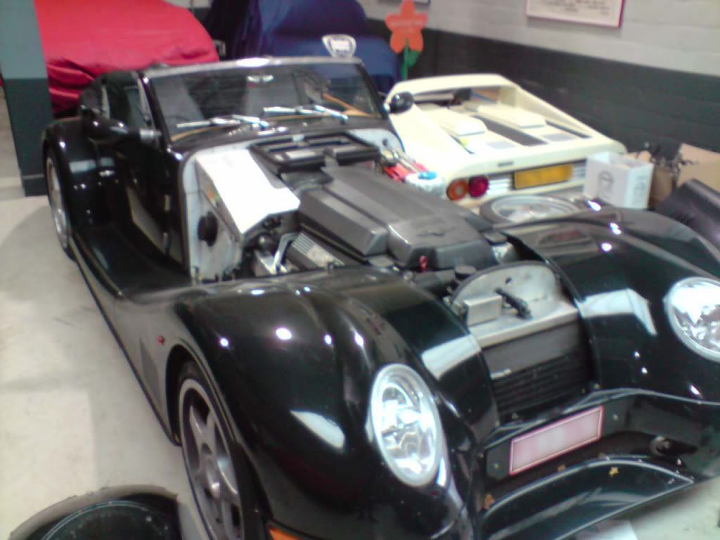

Joined: May 2007
Posts: 287
Joined: May 2007
Posts: 287
My mechanic just takes out the whole nose section for filling up fluids. Looks harder than it is.
