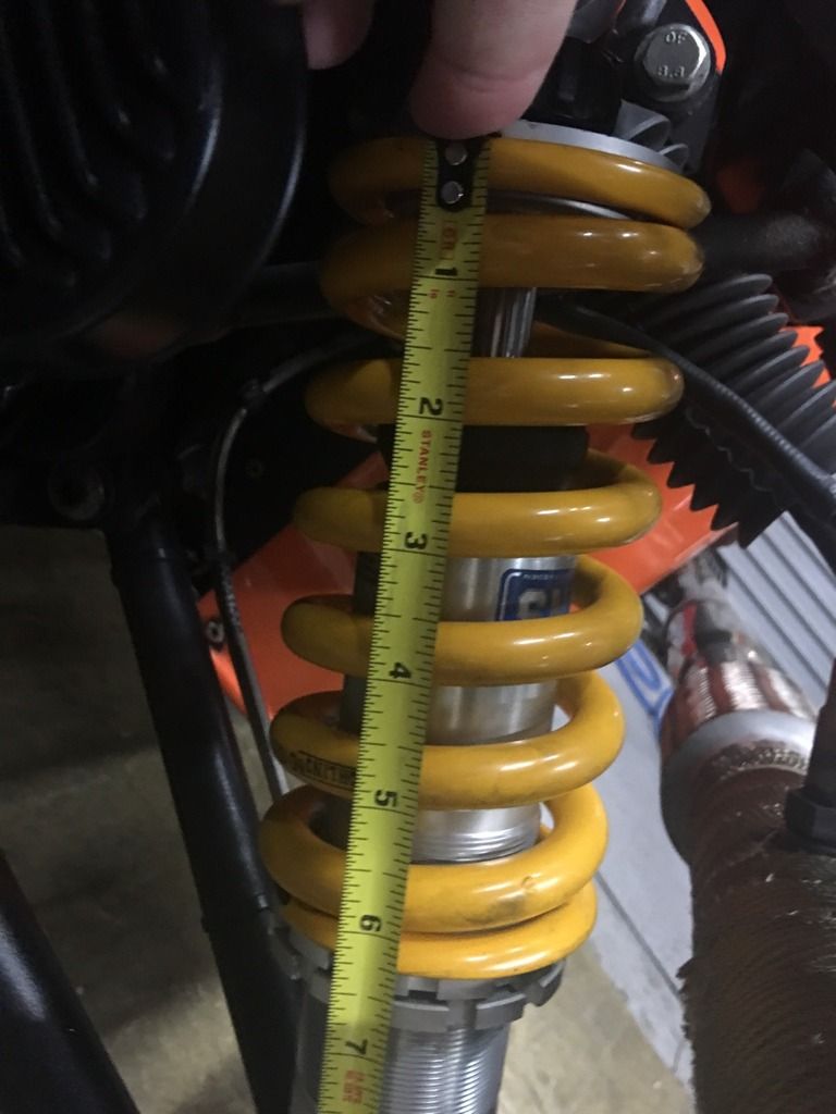

Here is the spring with no weight on it:
Here is the spring with the weight of the machine on the front suspension

The string rate of 742 lbs I think is way too stiff.
Maybe a rating of 250 lbs for our M3W
Along with tge shocks mounted at a 45 degree angle?
Most applications are at a 20 degree angle so this maybe be part of the problem too.
I'll be talking with the ohlins tech later this week on getting an update spring to test.

skullmog #413358 06/12/16 06:20 PM
Joined: Jun 2016
Posts: 433
Joined: Jun 2016
Posts: 433
If I understand your measurements correctly, the spring/shock is "topped-out" with the static weight on the front? That would make for some very squirrelly handling I would think with no suspension droop available at all! The 45 degree angle and the leverage of that along with the location in-board from the spindle gives the suspension some mechanical advantage over the spring, but there is no way that it should be topped-out at static ride height.

JVS, I too think I would back the pre-load off, the shocks really shouldn't be topped out with weight on them. From the measurements I'm running about 1/4" less pre-load than you are and have very supple suspension that certainly appears to be using full travel.

Yes, backing off the pro-load is something we'll try but the 750LBS spring is too stiff too.
