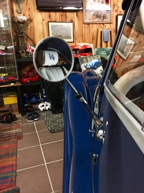

80th altered mirror images
From the classics section, how to change your views.

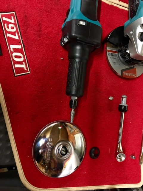

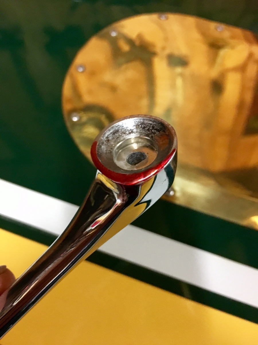

Bumped up in case anyone wants to make the standard mirrors work.
I elongated the hole In the mirror back and buffed the face of the mounting post to allow more movement, worked great since.

Thanks Ewn.
I’m glad you explained what you had done as I couldn’t tell from pictures (although others obviously could laugh2)
Think I’ll take the easy option out though smile

I think away back then, there had been a discussion on the trad section about how useless the mirrors were and at the time, I didn’t know how to post picture into those sections, hence the lack of description on this thread early on.
