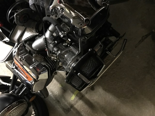

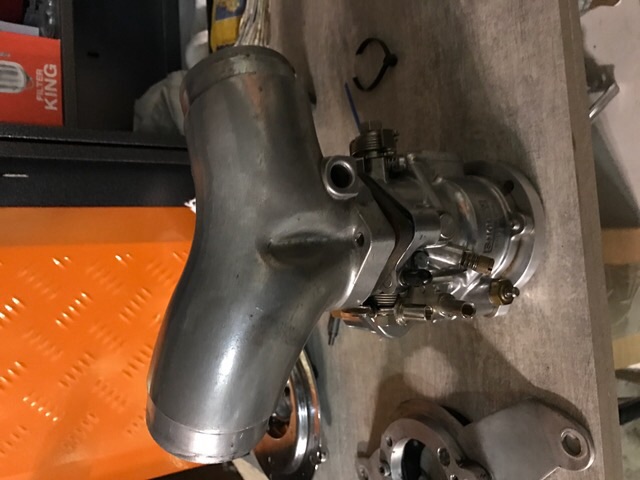

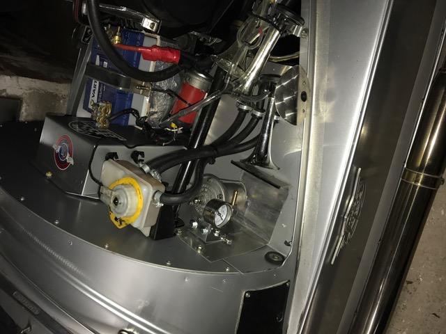

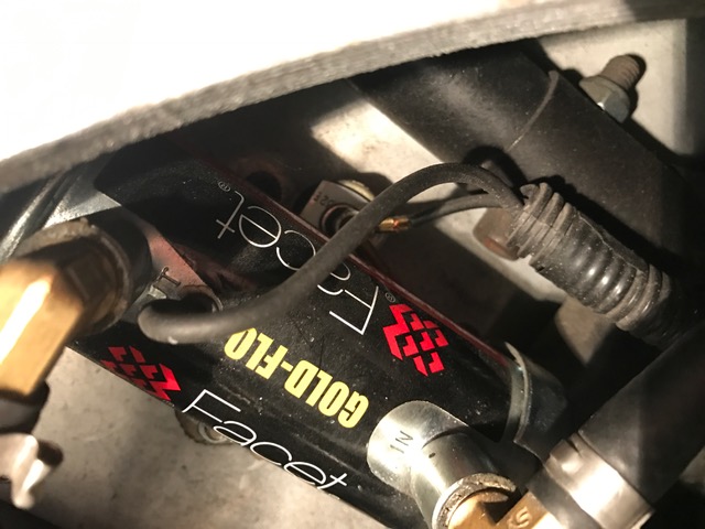

Î bégin to install an S&S super G Carburetor with a filter king And A Facet flo pump

Filter king

Interesting! What is the reason for going to a carb setup?

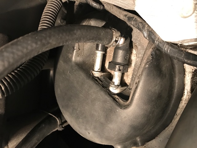

Î changed Two fuel pump And Î believe than the ecu box is out of order .
With Carburetor Î put lo présure fuel pump with A regulator
No more problem And Î expect to be on th road soon.

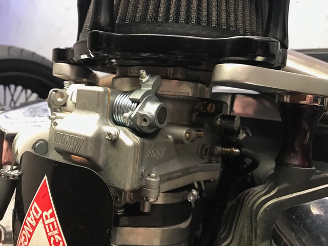

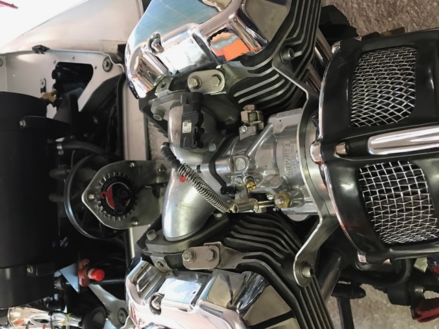

Î bought an S&S super G Carburetor which was on my friend Mtw .
He changed it for A Mikuni but thS&Swas correct for use.
Photos comes from my friend Mtw

Quite interesting. Which Mikuni is that?

Advantage of Mikuni over an SU is availability and range of parts for tuning. The one I had on my Velo had so many jet and slide options it was bewildering!
But I don't think you can beat an SU for simplicity and reliability, not that many moving parts.

Î understand why the S&S super G was replaced by a mikuni
The super G is 48 mm diameter inside And the mikuni is 53 mm as the admission collector. Î must adapt it.
atalante83 #435077 08/03/17 03:12 AM
Posts: 306
Posts: 306
Which mikuni is running 53mm? My go to is the HSR but I they top out at 48mm as well.
atalante83 #435084 08/03/17 06:04 AM
Posts: 2,360
Posts: 2,360
Sorry the mikuni pipe in caoutchouc used is 53 mm as the admission collector fixed with origînal screws And it is fixed on the Carburetor by a serflex like motorcycles .
atalante83 #435133 08/03/17 10:04 AM
Posts: 306
Posts: 306
Ah I get you. Cool cool. So is that a 48mm HSR then? If so I'm definitely curious as to how it performs.

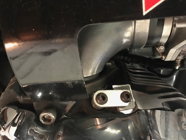

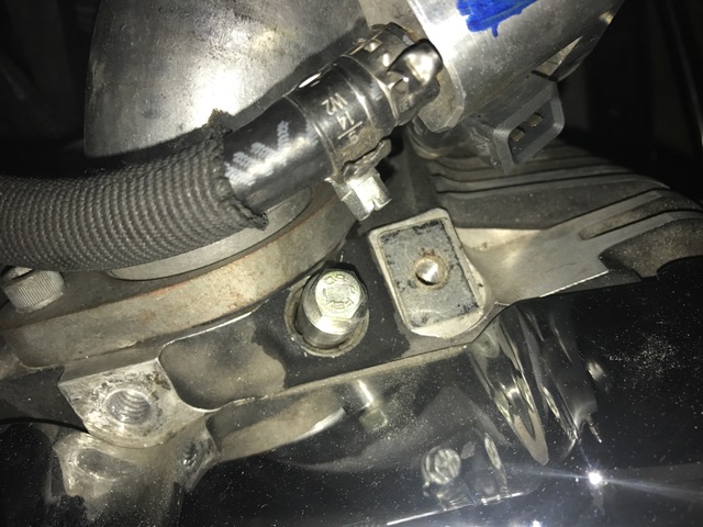

On the way..

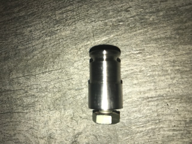

Inserts for injection holes
atalante83 #435440 09/03/17 06:24 PM
Posts: 2,360
Posts: 2,360
Insert

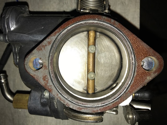

What's the shot of the throttle body for?
atalante83 #435709 11/03/17 06:02 AM
Posts: 2,360
Posts: 2,360
For seing new holes of 5 mm

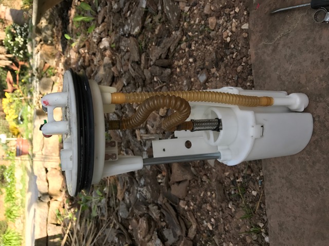

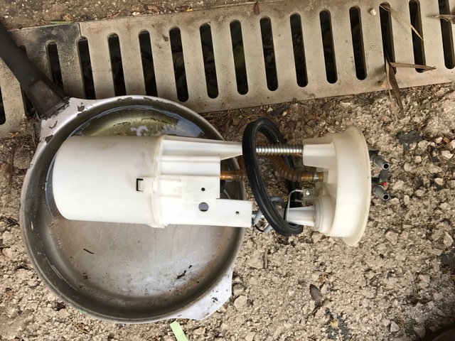

Body fuel pump
atalante83 #435905 11/03/17 10:19 PM
Posts: 2,360
Posts: 2,360

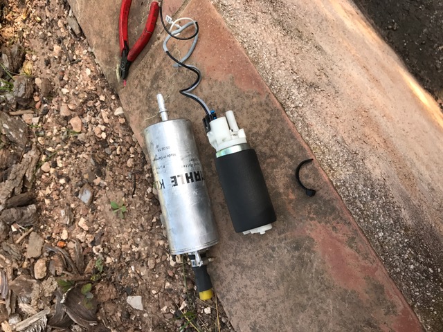

Fuel pump And fuel filter for injection
atalante83 #435907 11/03/17 10:24 PM
Posts: 2,360
Posts: 2,360
Fuel pump body without fuel pump modified for connecting filter on the bottom of the body

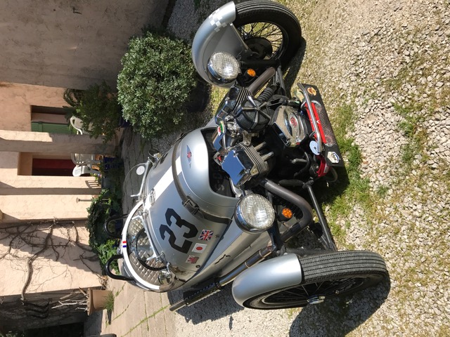

On the road again

100km with the new installation
It seems to be good
