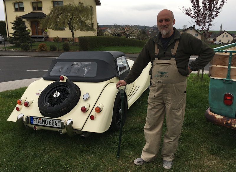

Nut Cracker Tool
Had a slow puncture over the winter & had to get the wheel off.
Tried the old "hammer" trick with no luck so had to go to a expert !!!!

These bad boys are the business I have one which I use in conjunction with my socket for the Centrelocks I have on my Plus8.
Standard bar and socket.
Centrelock socket with 600mm bar welded on to give the correct torque for tightening.
I use the tubed handle section of the standard bar to untighten slipped over the solid bar.

Don't want to be rude, but how long is it Rich???
And where can I buy one????
('cause the hammer solution is useless)

I'll just nip out and measure it.
Total length 1,500mm.
I know MG spares make one - this one came from Millers in UK and is pretty heavy so freightage to you would be expensive.
I've never been happy with the hammer solution - it's a disaster waiting to happen.
As you can probably tell by the photograph John the standard bar only uses the factory supplied flat spanner welded with strengthening pieces added to it.
Very impressed with the Bentley suit thumbs.
