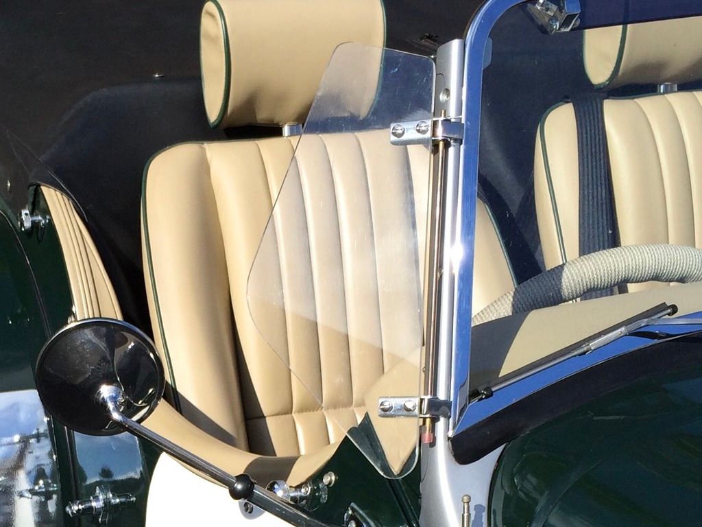

I know I've posted this before but why not make them removable ?
Here is a picture of Andy's from Lifes Motors 4 seater Roadster with a long removable pin/rod holding the deflector on - easy to remove when using sidescreens

The Simmonds wind deflectors are held on with 2 hex screws each side, so hardly a major effort to mount/dismount them.
I would be a bit concerned that a QD solution might result in them not being firm enough to resist the wind blast, and end up with them constantly swinging inboard and requiring adjustment, maybe?

The brackets/hinges prevent those type from swinging in any further than shown in the photo Tim. At least mine on RTA did... smile
Ah, of course. The Simmonds type are designed to swing all the way in so they can sit inside the sidescreens.
