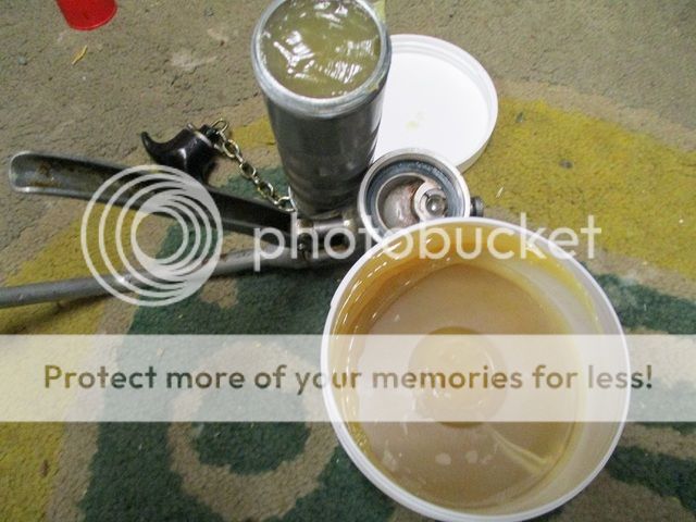

Grease wise I'm not going with any fancy stuff, just a Lithium based EP2 grease as used by Oakmere, I guessed it sensible to match up with what they will put in it for the next 3 years.
Right, loading the gun, again I'd read some funny stories on various forums about mishaps, correct filling procedures and pitfalls, as an ex toolmaker I'm not daft but reading some of these posts did give me the wobbles grin2 I hasten to add, this little Mog forum had no such tales of woe!!
This morning with 489 miles on the clock and pouring rain outside I decided to bite the bullet and do the "first grease" coffee

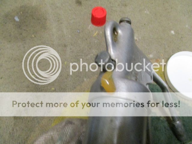

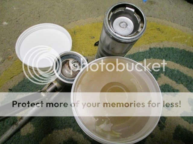

First off I decided to get my head around how the Wanner actually works. I took it apart and gave it a good going over, removing all visible seals, cleaning with wd and replacing with a smear of new grease. I flushed out the 2 valves also and was ready for the first fill with hopefully no issues.
This was the bit I thought may get messy. However I remembered on a boat we had a few years back it had a stern tube greaser, very similar body to the Wanner. To fill it I just used to put the body over the plastic bit with the hole in it on top of grease and pull the piston back whilst gently pushing body in to the grease, could it really be that simple again after what I'd been reading? lol.
Indeed it was, it filled like a beauty yanking back slowly on that chain with no mess or grief whatsoever. I put the dispensing head back on and released the lower control valve and it bled perfectly.
Got under the car, did the drivers side easily with no trauma. Waited for the pop as the seal breached and job done. Passengers side exactly the same.

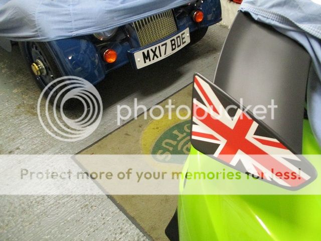

Is that a Lotus badge painted on the floor?
Hi Dave, it's an old Lotus Dealership door mat, I need a Morgan one too now thumbs

Ah it even looks like the right font! innocent
Gill Sans?
