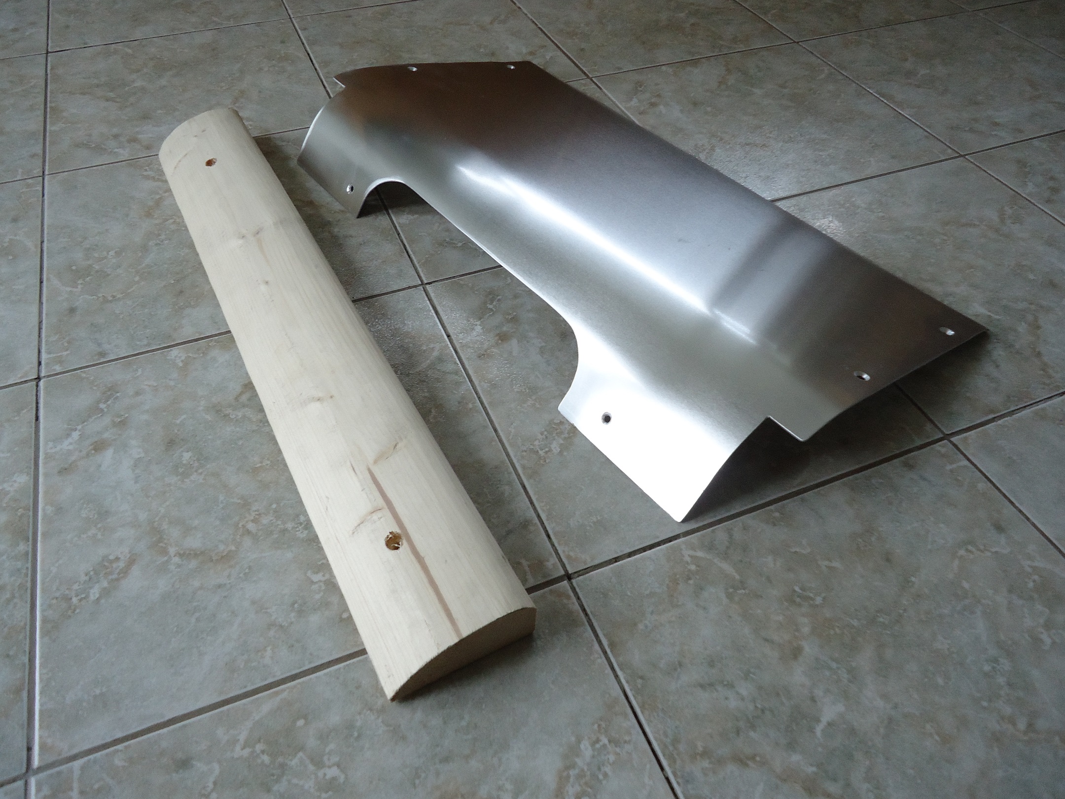

This is the last one I bashed out in the garage. Made from 2mm sheet and really strong. Had to make a wooden former first.
