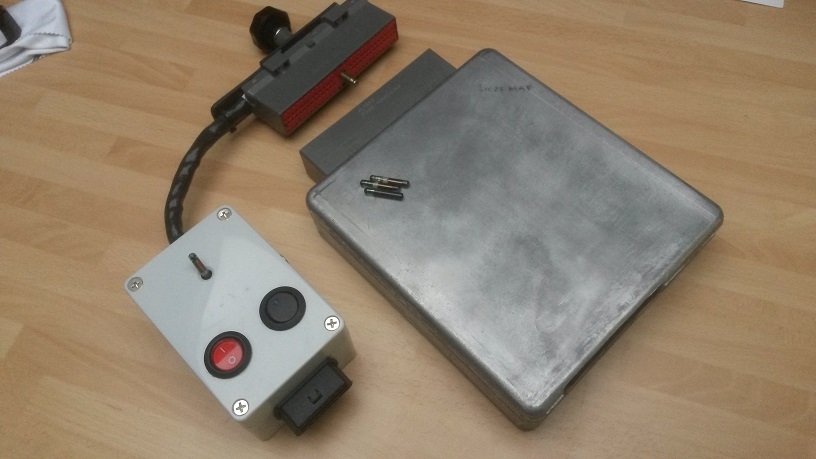

Where do I begin…. The way I put maps into my car is by using the little interface box in the pic below. I had some ecu issues in the early days with my car and finding help or information for a Morgan ecu’s was almost impossible so have now knocked up this little device that allowed me to play. I must add the caveat that I know diddly squat about electronics or cars and would not advise anybody to mess with their ecu without the advise from an expert.
I acquire my spare ecu’s by looking out for suitable donors from good quality second hand Ford units that come up for sale from time to time. With the aid of various bits of software this device allows me to install Morgan maps into the Ford ecu on the bench. It also enables me to delete the old PATS immobiliser data so I can re-program a fresh set of key chips.

Thank you for info.
I have this annoying metallic sound from the engine when I press the throttle pedal. It will be less if I use 98 Oct gasoline. The engine is a bit trimmed with complete Librands and K & N. Is it possible to buy an ECU ready configured from you when you get it perfectly? (have the best of both worlds, the open loop performance parameters and the closed loop from the Plus 4)
