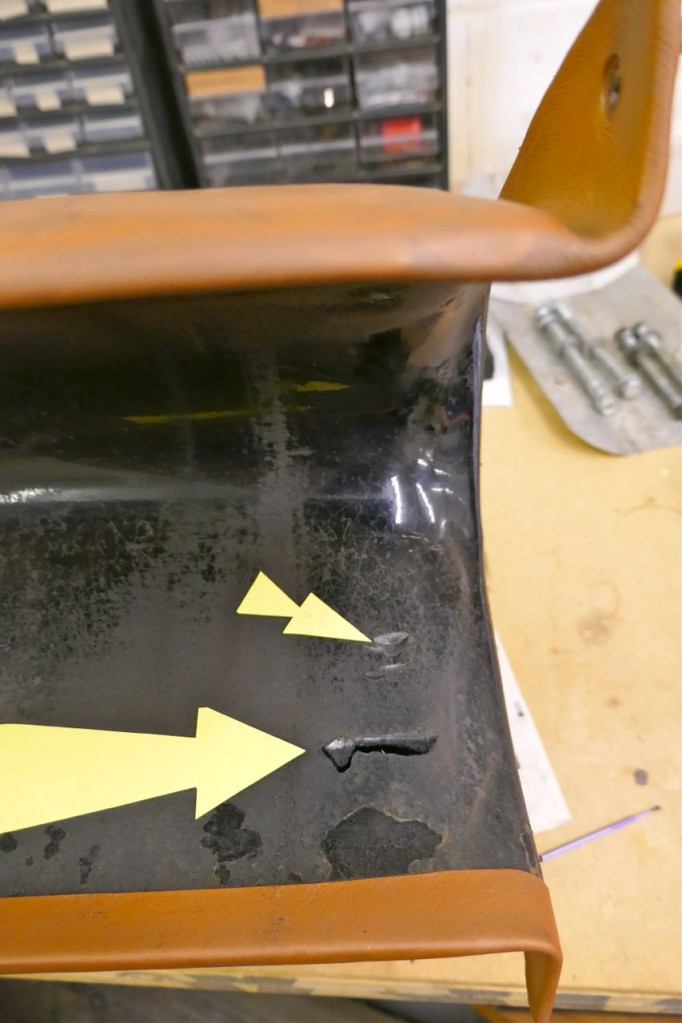

I'm in the middle of fitting one of Phil's kits to better locate the bevel box to the chassis. As I've removed the existing gubbins, I've found telltale signs that confirm that the NVH hardware has allowed significant movement of the bevel box.

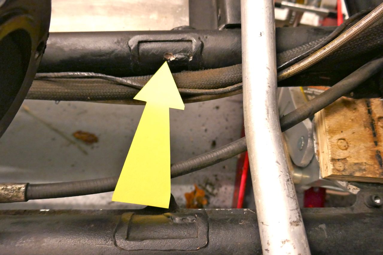

This photo shows where part of the NVH hardware has been striking the chassis.
...and these marks are on the transmission tunnel cover:

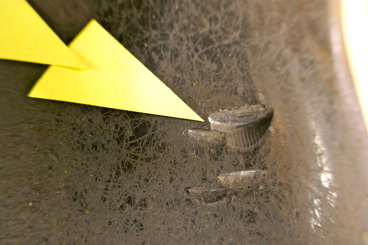

A closeup showing a nice imprint of one of the hex mounting bolts:
I'm sure this explains the loud clonk when getting off the line (especially when carrying a passenger) and I can't wait to be rid of this unwelcome feature!
Of course, the irony is that my (early) chassis originally had the BB hard-mounted to the chassis but the previous owner had had it 'upgraded' to NVH spec! doh

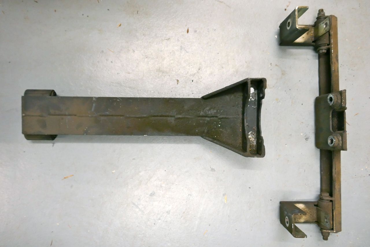

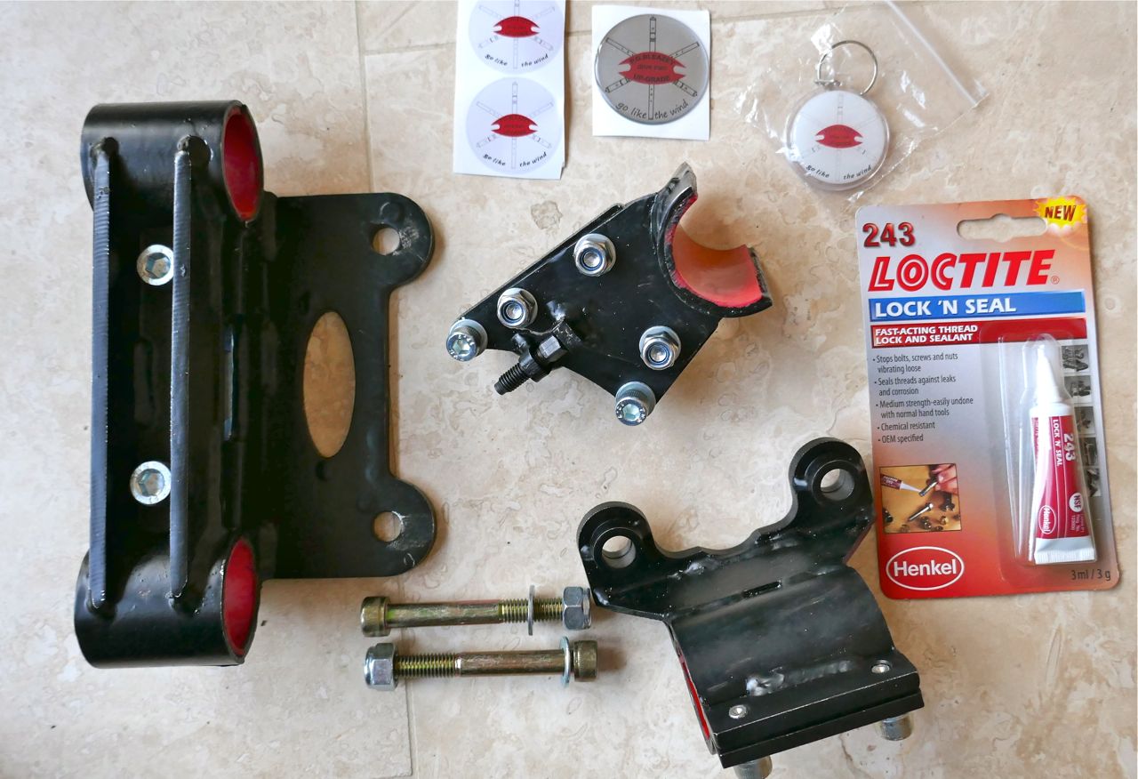

Here is the BB mounting kit as received from Phil. Weight of all parts: 3.4kg (7.5 lbs)
And here is the old NVH hardware: 9kg (19.8 lbs)

Is it just a case of removing the old NVH parts and fitting Phil's kit or do you have to remove all the mounting hardware as well?

Hi John,
Yes, basically you remove the NVH kit and fit Phil's BB mounting brackets instead. It's quite a big strip-down involving removal of most of the interior trim but nothing too onerous for the home mechanic. For more details may I refer you to the installation instructions: Bleazey BB mounting kit
