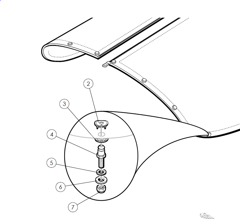

Use rivet pop stainless steel diameter 5 mm / 18 mm length, do not forget washer fiber between rivet and bodywork, the same washers as for the tenons of the tonneu cover
Joined: Nov 2013
Posts: 786
Likes: 18
Joined: Nov 2013
Posts: 786
Likes: 18
WASHER FIBRE M5x10x
Joined: Nov 2013
Posts: 786
Likes: 18
Joined: Nov 2013
Posts: 786
Likes: 18
N°5
