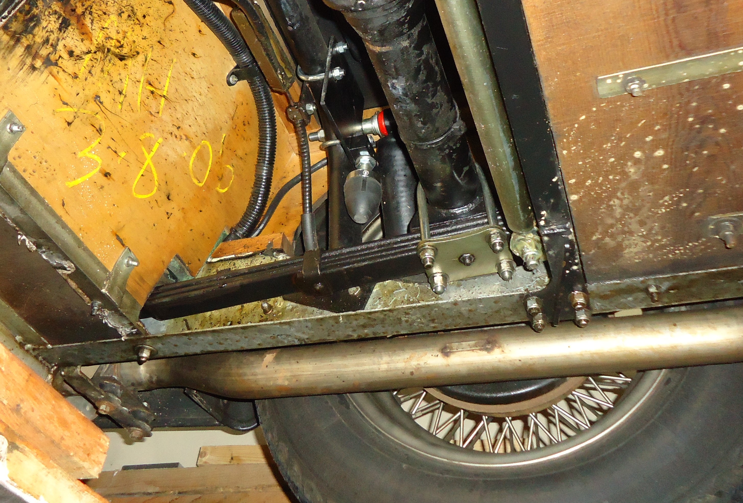

Originally Posted By Button
Why not cut the plywood a bit to make room for the spring.
Chances are something else would contact, maybe the dif cover
Roger

My stops are set to absorb the energy rather than the bodywork.
It’s a much nicer ride woohoo

Originally Posted By Michael P
Is this a standard damping element (I mean the rubber cone)?
Yes it is but not Morgan. It’s a modified BMC Mini item.

Rog, those bump stops really are great.
Just out of interest on my 2011 4/4, I used to get quite a thump when the rear suspension was shall we say exercised. The thump was much reduced when I ensured that the jack in the tool tray was secured.

The problem has now been solved:
There were two reasons:
- the propshaft touched the tunnel and
- the universal joint touched the end of a screw with which an eyelet for our dog was fastened.
The solution:
The tunnel was set approx. 1.5 cm higher and the screw was replaced by another one (instead of the hexagonal screw a door hinge screw[has a flat head] and inserted from bottom to top instead of from top to bottom as before.
I have a question that is probably typical of newcomers (I searched the forum but found nothing - although it has certainly already been discussed):
During the first rides with our new Plus 4 I noticed a noise several times during bumps. It sounded like there wasn't enough travel. What amazes me, however, is that it wasn't a big bump. There were 2 persons in the vehicle (approx. 160 kg) without further payload.
What's beating what?
Is there anything to consider here, or are "they all doing it"?
A quick check to see the car is not sagging to one side(usually drivers) is worthwhile. There is plenty on TM on the subject.
