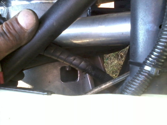

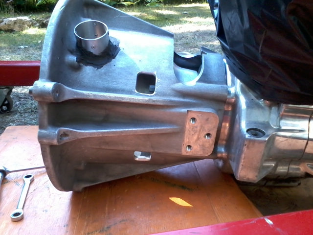

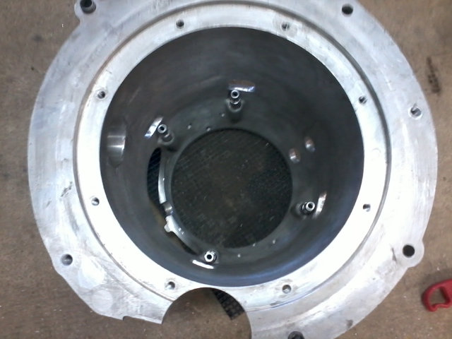

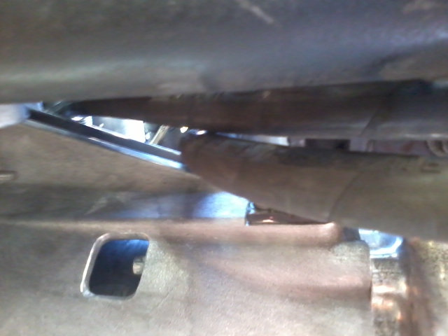

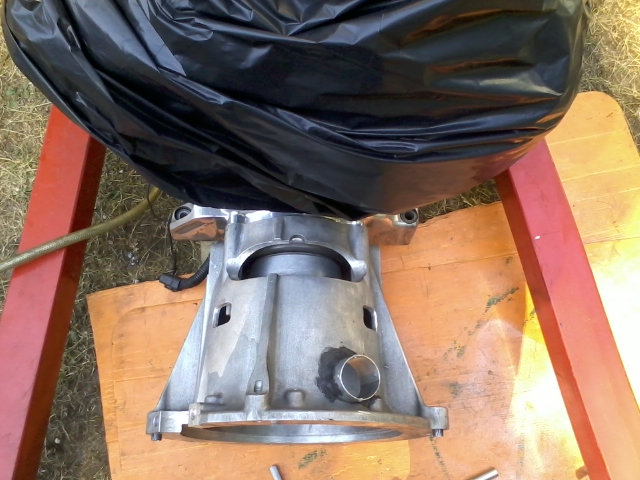

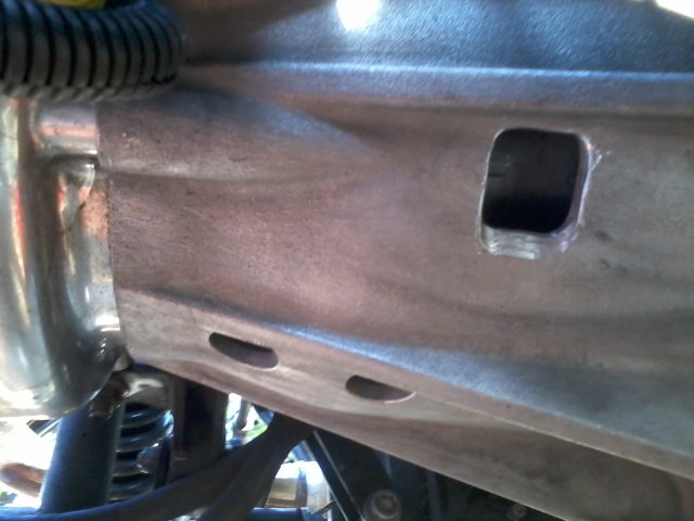

I have a spare rubber set, for my Centa crankcase ventilation I have to mount the two fans together so that the Centa crankcase does not exceed 50 ° C in any circumstances even operate at a standstill.

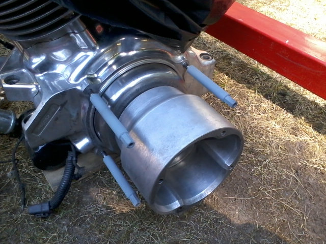

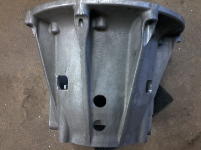

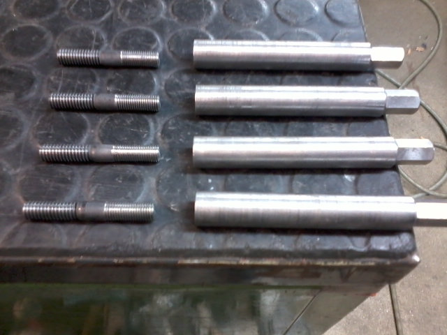

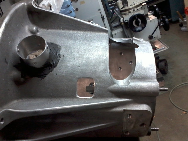

Clever modification allowing you to detach and remove the engine from the drivetrain assembly leaving everything else in situ.

Looks good,and deceptively simple too.
Bet there was an awful lot of thought and worry before cutting the first hole!
