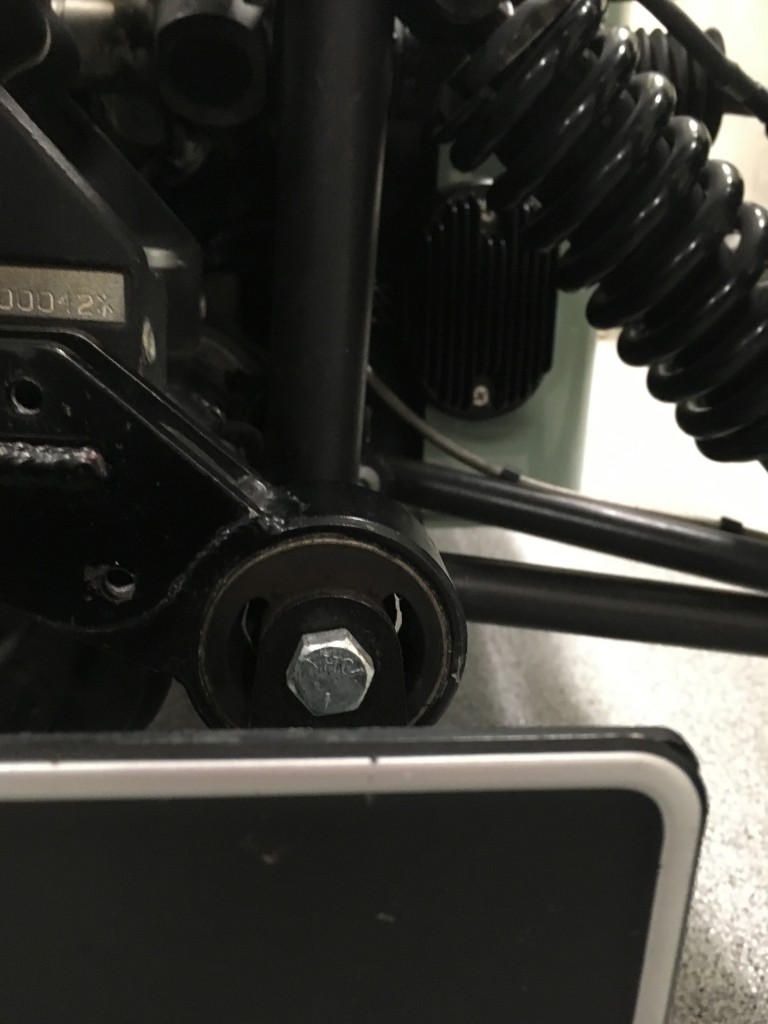

so I removed it.
Or more correctly, relocated it. Referring of course to that fugly factory rectifier that afflicted the early 5 speeders. Used one of the alternative P/Ns found on this forum, and following a comment from Phil Bleazey mounted it on the front edge of the body using rubber washers (plumbing supply parts) to separate it from the paint. Pretty much disappears from view, but has a straight shot to cooling air.

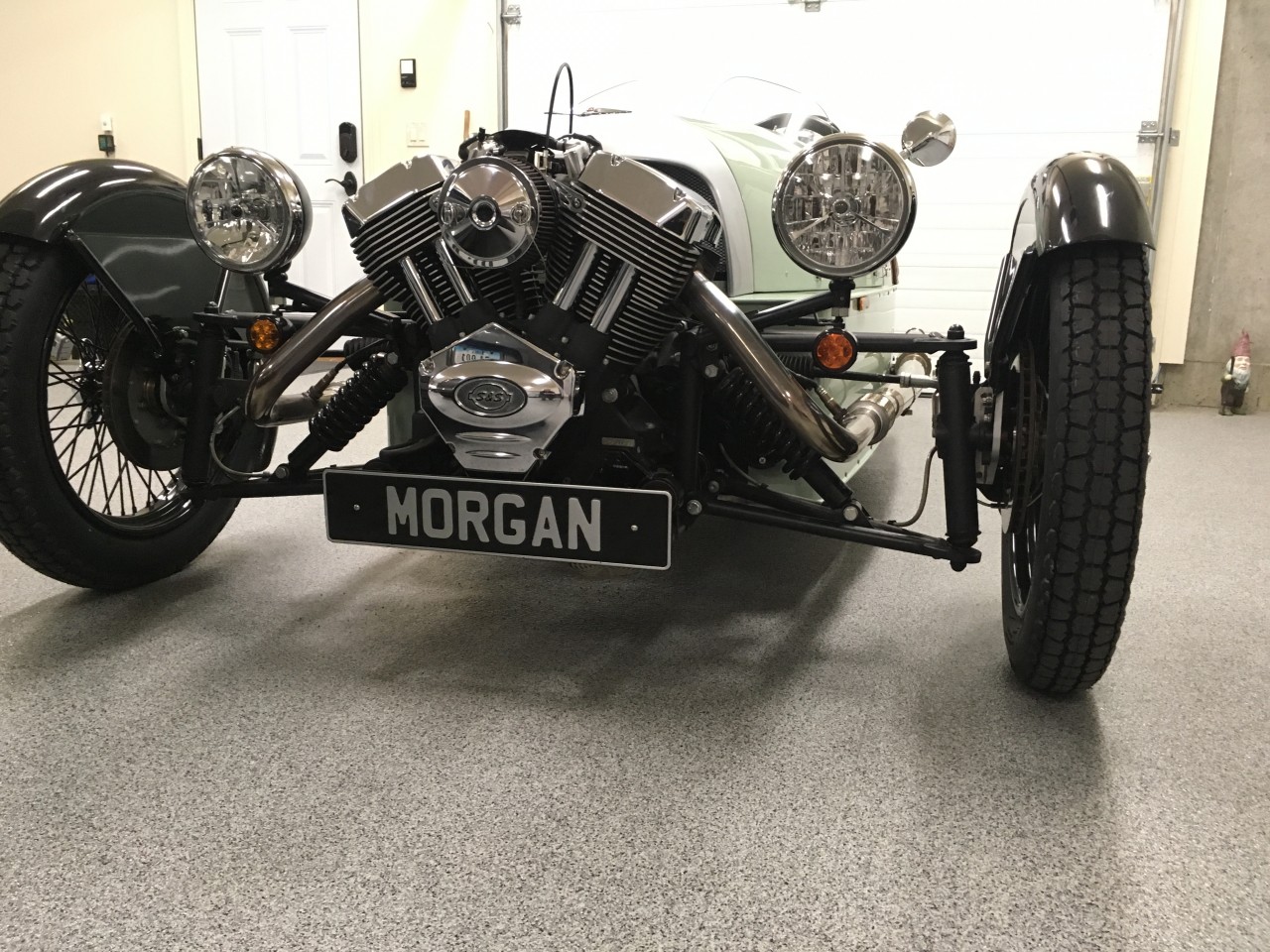

Love your headlights, and would appreciate a cross reference.

If you hadn't taken the close-up I would never have spotted its new location! thumbs

[quote=Piloto]Love your headlights, and would appreciate a cross reference.
Tom,
Headlights are from Speedwaymotors.com. Search there for "tri bar headlights.
Several web retailers sell them.
Not the easiest install as the spring clips Morgan uses are the old school motorcycle type. Also, by using this type of headlight you lose the sidelight feature of the original lights. They do make tri bars with built in turn signals, which may allow for the sidelight feature.
