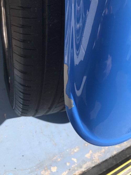

Repair is slow
I’ve realised my method of building up the paint wasn’t the best so I’ve sanded back and I’m preparing for some high build primer

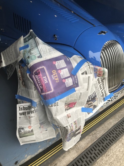

I took a ‘brass rubbing’ of the area and masked the area and have got several layers of high build primer on it

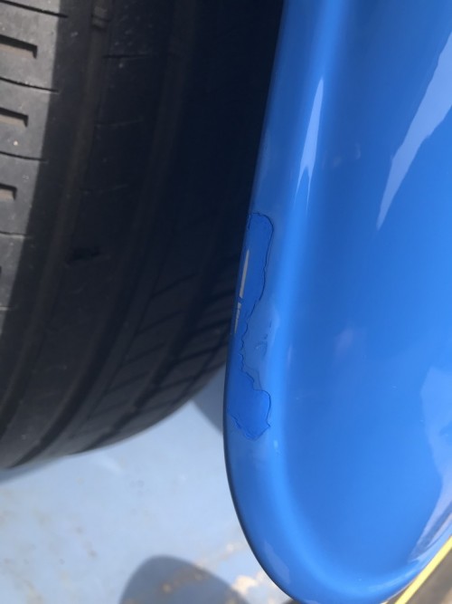

Stuart, you have my sympathy.. I backed the red 4/4 into the garage late one evening & scraped the rear wing on the brickwork.
Have to say I admire the way you're having a bash at some repair work yourself, after all if you have to pay someone to fix it professionally, you may as well have a play first.
I'm probably wrong, but shouldn't you feather the edges of the paint before you apply the primer..? It just appears that you'll be hard pushed to get that ridge edge down.
Steve
I did with some sandpaper and then made my mask about 1mm larger than the area all around

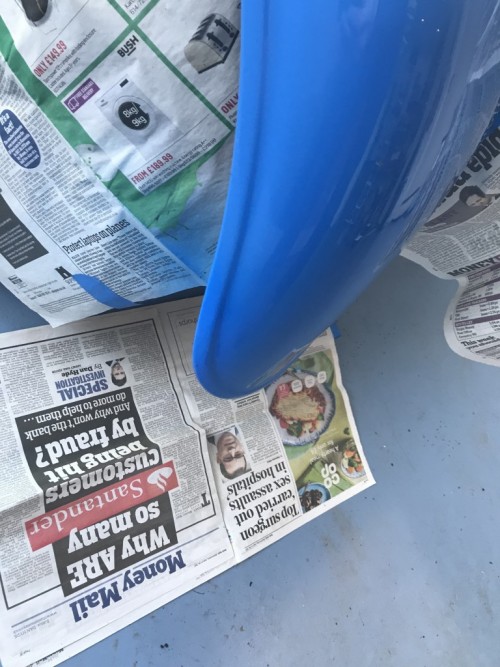

Pleased with the high build primer
Now to sand down and smooth out

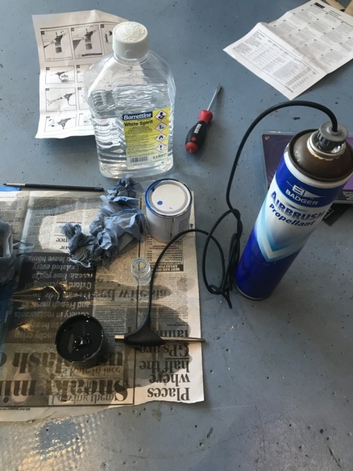

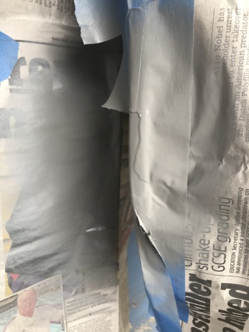

Got the modellers airbrush out and have just given it its first coat
I’ve got the tiniest of runs but I’m confident with a bit of polishing - my garage wall scrape never happened
