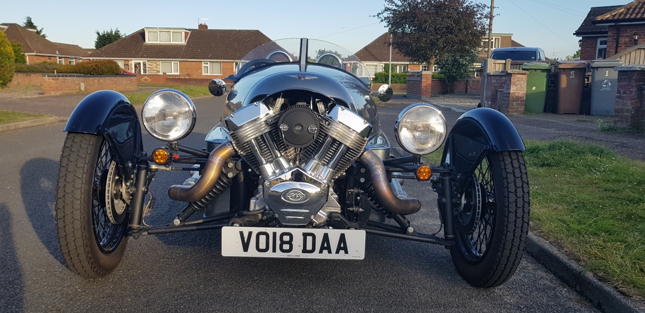

I thought I would share my thoughts on my recent upgrade.
I've not been an owner for very long, in fact less than a month. My plan from day 1 was to take the car, upgrade wise, as far as I could.
I got my car on the 26th April and last week it was in with Krazy Horse having the stage 3 upgrade work carried out. For those that don't know stage 3 consists of:-
Air Filter
High Flow Headers and exhaust
Stage 3 ECU
Stage 3 Camshaft
Live Dyno Tuning
My car is an EU4 so was down on power over an EU3 car, Morgan claim 62hp from the factory. The car drove well and sounded ok. I did have a few issues with the car stalling all the time which was hugely frustrating but I knew it would be fix when the work was carried out.
Krazy Horse had my car for 3 days and completed the stage 3 work. The difference in the car now is amazing! It drives like a totally different car and sound is something else. The sound isn't for the faint hearted but it's exactly what I wanted. After all its a toy not a daily driver.
The car pulls away nicely from 1500rpm and the low down torque is very impressive and it revs out free and easy to about 6k. The dyno results show 99hp and 108Ft/lb to the crank.
I've now had the car back for a week and covered about 200 miles since Friday and smile hasn't gone away and it won't for some time. There are still some small issues, nothing major and I know when car goes back for the 1000 mile service next month everything will be sorted.
If anyone was thinking about have this work carried out I can't recommend it highly enough. Now planning the next round of upgrades but for the moment I'm just enjoying it.

A very interesting report Johnny and very positive. Enjoy your miles.
I have to comment on that exhaust, it looks very serious at the front end there and has certainly but the bite back into it visually.

Hi Jonny,
Wow, those exhausts look the business.

Great report and pics Jonny.
Those pipes sure do look amazing!
Delighted that you are enjoying your wonderful car.
do keep us posted as things progress.
BTW those pipes would look great plated!

The upgrades make the M3W into the car it should always have been, and it's a shame it's all 'extra' to the already hefty price tag, but Way to Go..!
I love those header bends...look like my downpipes from the guttering..

That looks very slick! I bet it goes quite well too... innocent
