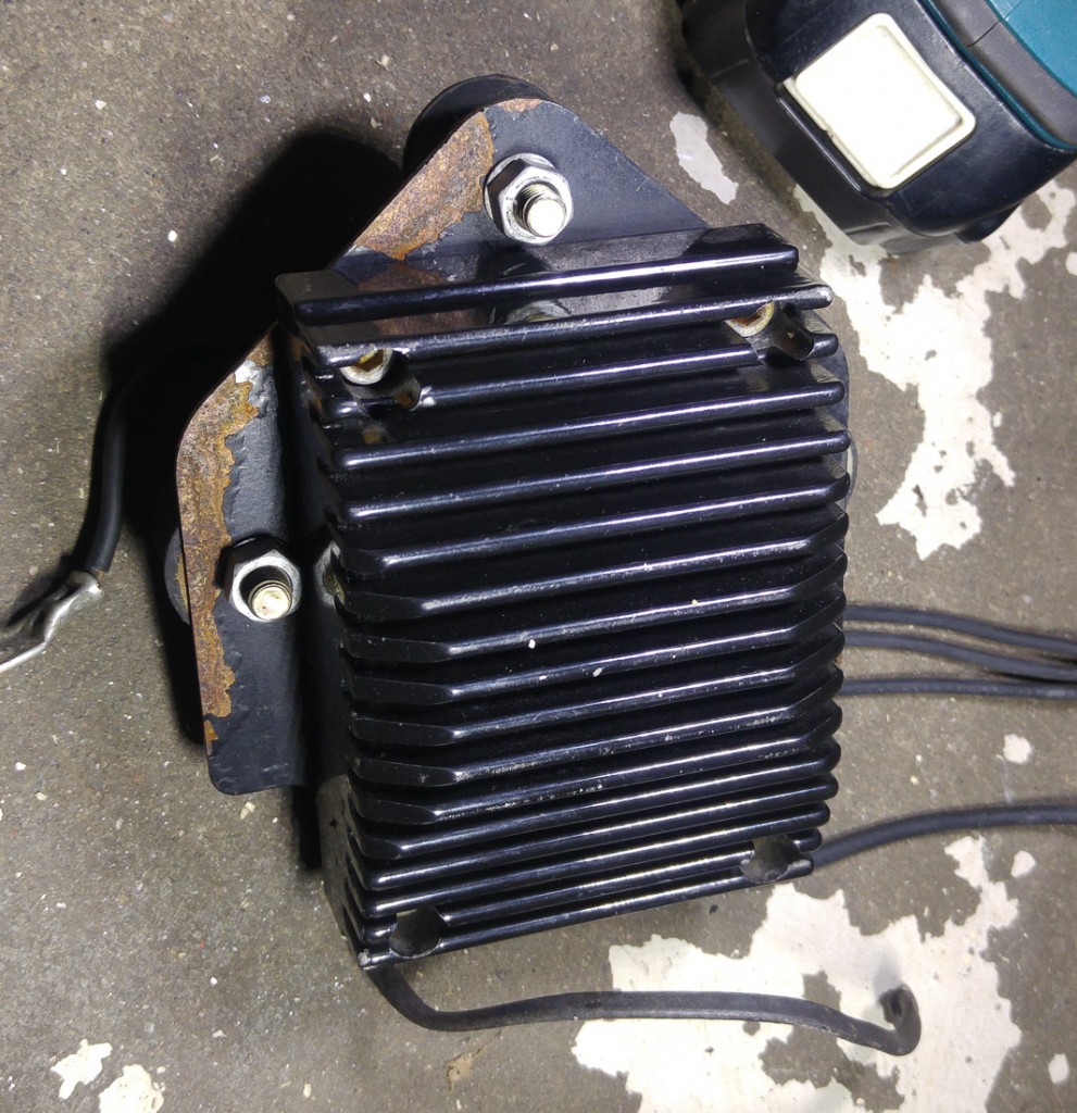

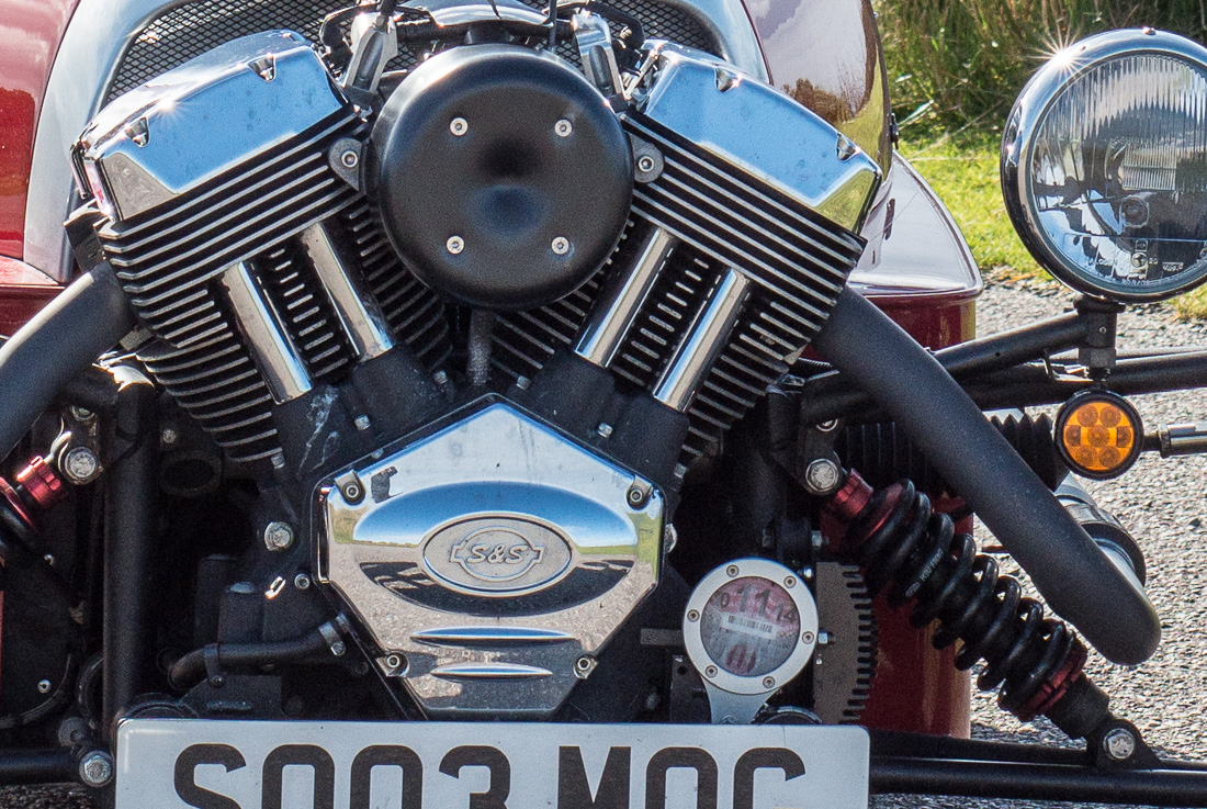

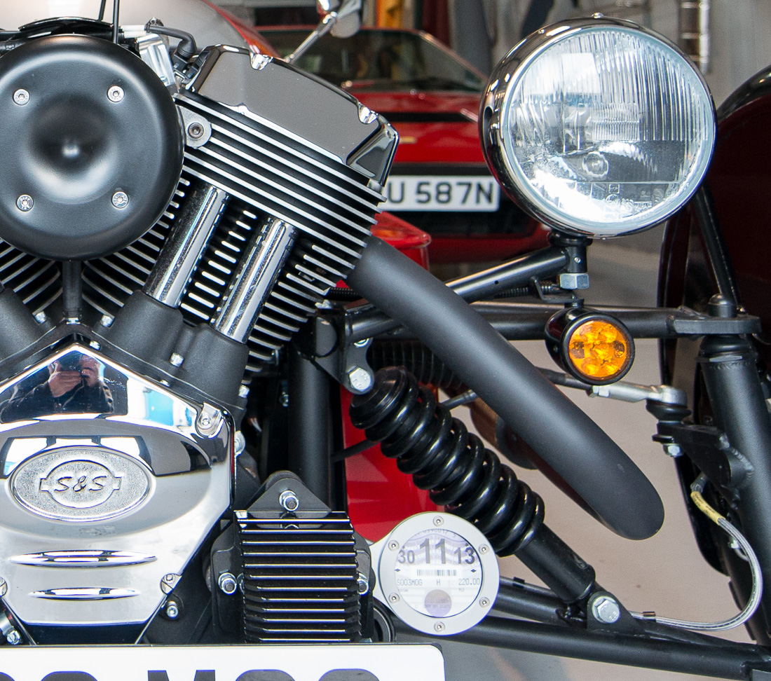

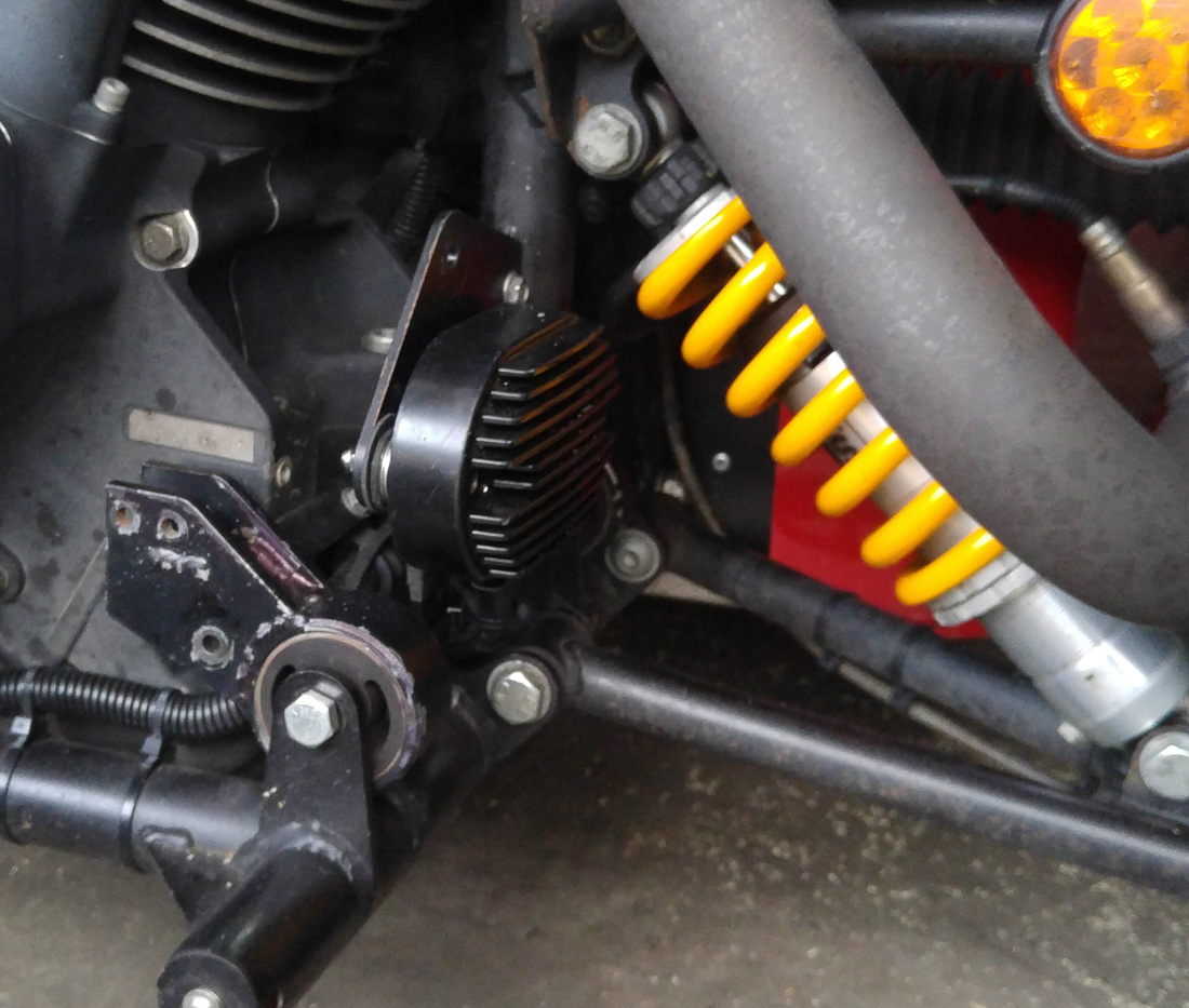

To follow on from above posts here's some pics of the regulator/rectifiers that could be fitted;
If it looks like this;
Then it's the original Morgan unit, is very expensive and will fail, possibly cooking the battery as it goes. It may be fitted this way;
Which is the original mounting or may be direct to the chassis which is the later and arguably better way;
If it looks more like this;
Then it is a cheap and nasty Harley Davidson clone from China via eBay and may well last forever. The real Harley ones are much more expensive and suspiciously similar

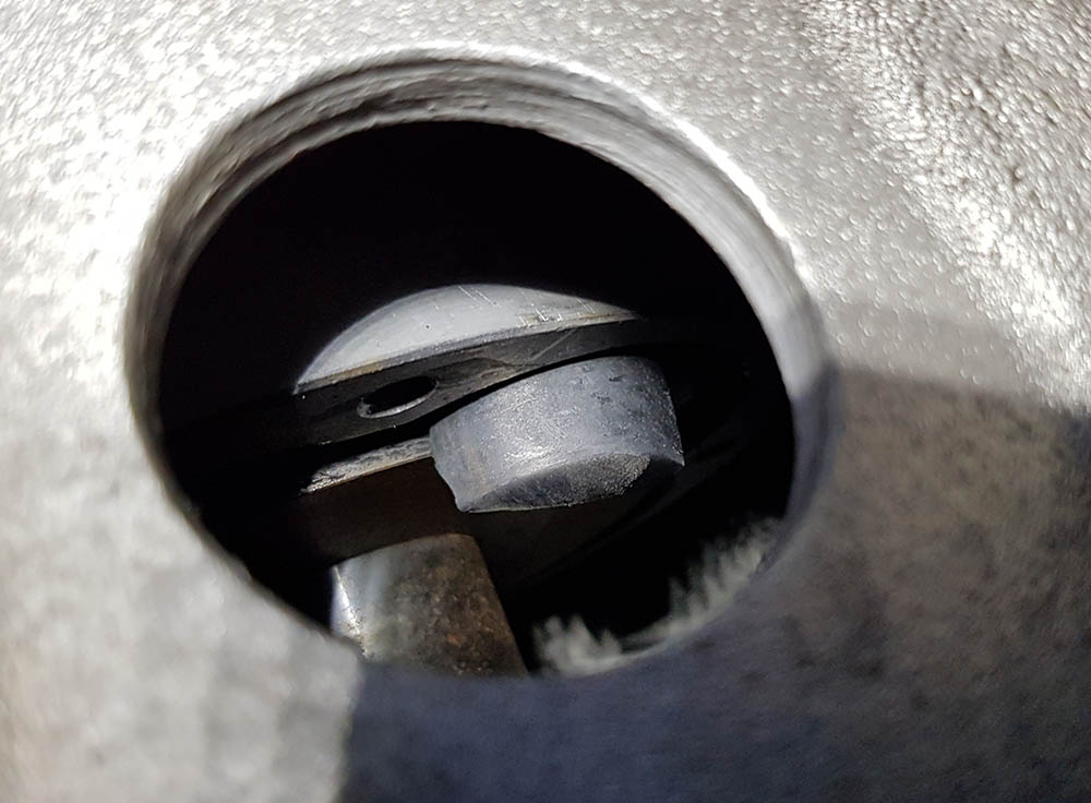

Telling if you have a Centa coupling or the earlier compensator is a bit more difficult. If there is no 2" inspection hole in the underside of the intermediate bell housing between the engine and the gearbox bell housing then you probably have the original compensator without the grease nipple and failure may be imminent!. If you have one 2" hole in the bell housing then you could have either the grease nippled original compensator or the Centa coupling; they had these holes drilled in slightly different locations depending on the type fitted. If there are two holes then it's a good chance that you have the Centa or the mechanic drilled one hole in the wrong place.
If what you see through the hole resembles this;
then not only do you have a Centa coupling but one of the four rubber rollers has broken up and is making a bid for freedom through the vent hole. Sorry I don't have a photo showing what it looks like without the bit of rubber sticking out but hopefully you will get some idea of what you would be looking at.

It looks like I have the original design of regulator. Is it the vibration that kills these ??

Seems to be a combination of vibration screwing up the internals and really nasty external cabling that has brittle insulation that wears through on the positive wire giving incipient and increasing short circuits before the final failure. The original earth connection wasn't great either which can't have helped. The Chinese and Harley regs need the connector crimp changed to a bigger one to fit the positive terminal in front of the oil tank.
