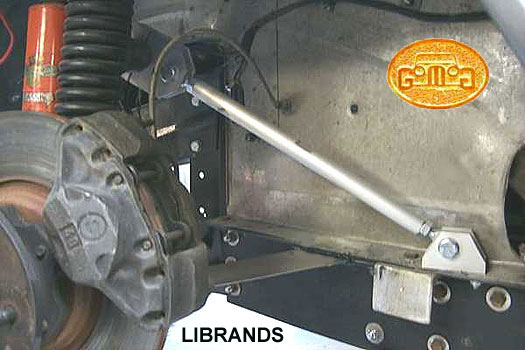

Unable to see them on my car during factory tour yesterday as wings already fitted, and didn't have opportunity to look closer. Just googled for images and found this
which is what I would expect assuming it takes the brake caliper force from a pivoting mount to the chassis.

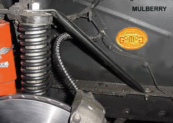

I also found this though
which to my mind is just an extra stay from the top of the upright, although I would grudgingly admit it would help supporting same under heavy braking.
Which is closest to that which MMC currently fit when included in build spec?
Posts: 8,682
Likes: 493
Posts: 8,682
Likes: 493
Identical to the Mulberry ones
If they fit them at customer request, the latter which is a stainless tube. I have to say....and I know I’ll get shot down here....that unless you are a hard braker, they are not really necessary. Which is why the factory don’t fit them as standard.

They are fitted to mine ( mulberry )
To be honest I can't tell any difference hide

Is there any concern that potentially they load a part of the chassis, that is not specially strengthened!?

Thanks for replies. I'm a great believer in having braking and acceleration forces transmitted to chassis rather than suspension although I accept the front suspension on the classic Morgans is a special case. It seems the optional MMC ones do not achieve that directly.
As to whether they are needed or not I can only draw on my greater experience with motorcycle engineering. For very many years Moto Guzzi and BMW produced shaft drive bikes with the bevel box directly coupled to the suspension swinging arm. Torque reaction from this caused the rear suspension to unload so the seat rose under hard acceleration. As this didn't make the bike dangerous under general road conditions it could be argued that a solution was not needed. Interesting though that both companies have developed fully floating shaft transmissions.

I had the Mulberry parts installed for a while in my 4/4 Sport ... I could not tell any difference.
What annoyed me was the fact that there is not enough clearence and the (stock) tires rub on the stay on full lock -> removed.
