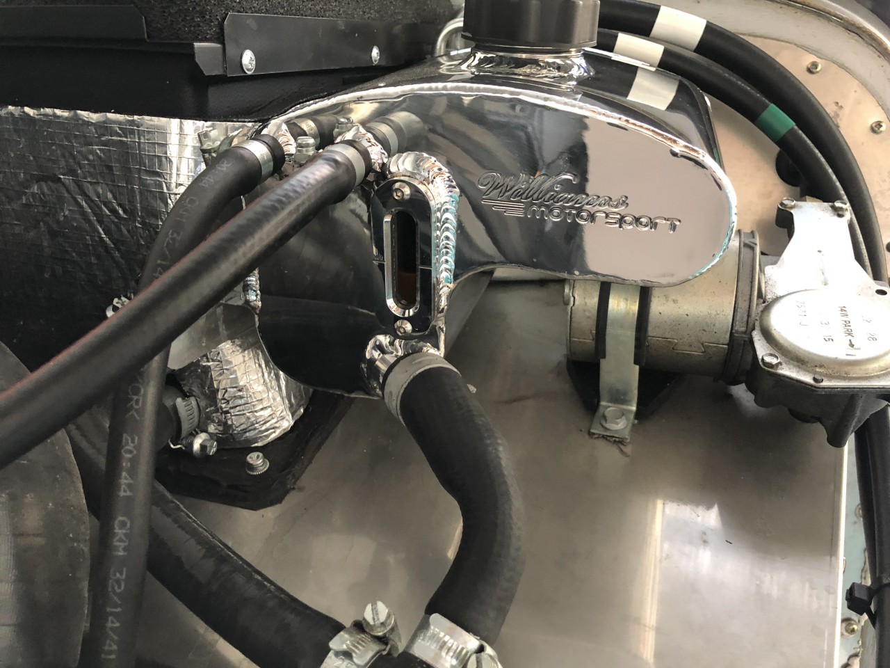

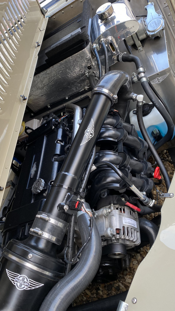

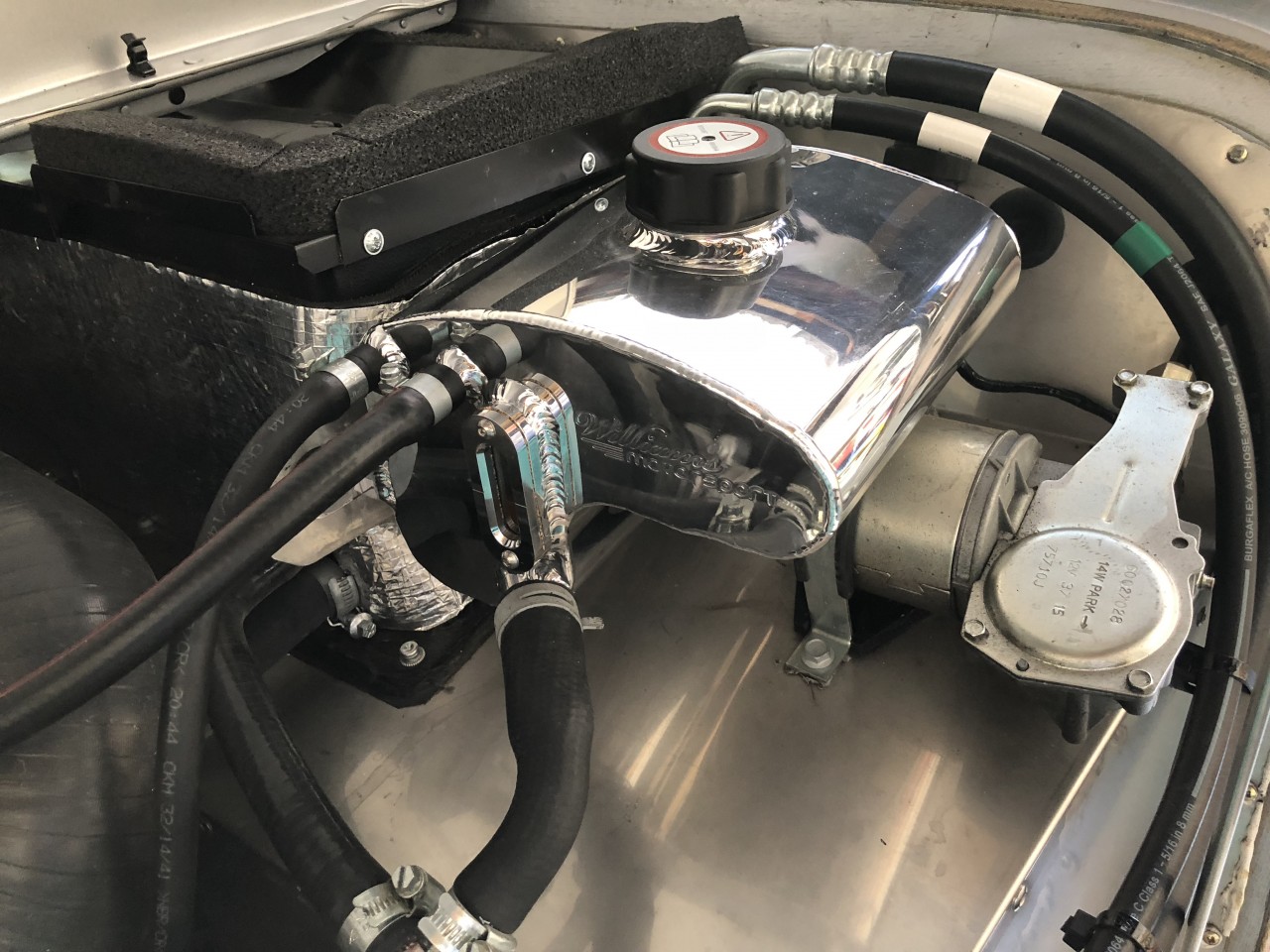

John, is that header tank still doing its job? And could you please post a picture of the whole engine bay - just to get a better impression of what it looks like in the engine bay...
my alloy header tank is still doing its job, they look great too - pics here as requested.
