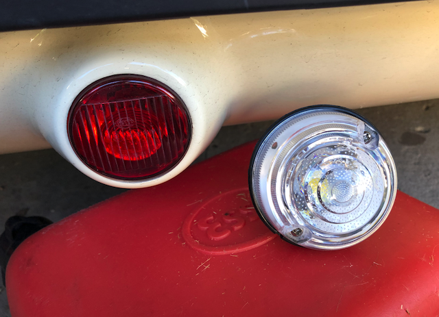

New LED Reversing/Fog Lamps
Any idea how I fit them????

Thanks guys. I was gonna remove the lower panel, didn't think about removing the spare & looking!!!!
However, Gill at "bettercarlighting", where I bought the parts has offered to replace the units with LED bulbs.
Only problem is these units replace fog & stop lamps in one go, so I now need a "clear" lens to replace the RED fog glass. Any ideas where I can get that from???

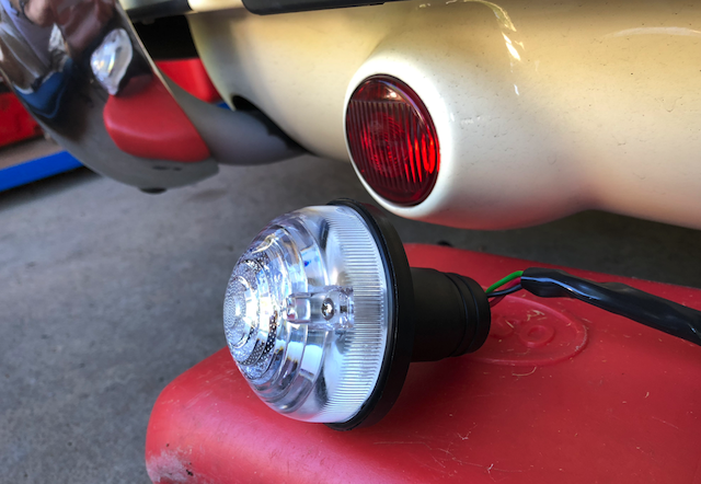

Oh, I‘ve just made such a conversion.
If there is somebody interested, pictures are possible by email.
Greets René

Sir John, if you need to buy another Hella replacement unit with clear lens try here via eBay, probably cheaper than via a dealer. No reason you cannot use a red LED behind red lens though. Just ensure the bulb replacements have a BA15s base.
However if you end up with both valance mounted lamps with clear lens you could consider dual reversing and fog lamps (fog priority) by looking at this thread. A lot more work as explained and you will need dual colour (red/white) BAY15d base LED's, but the main loom wiring is already in place for the dual lamps so you just need to add an extra cable each side within the existing 3 way plug.
