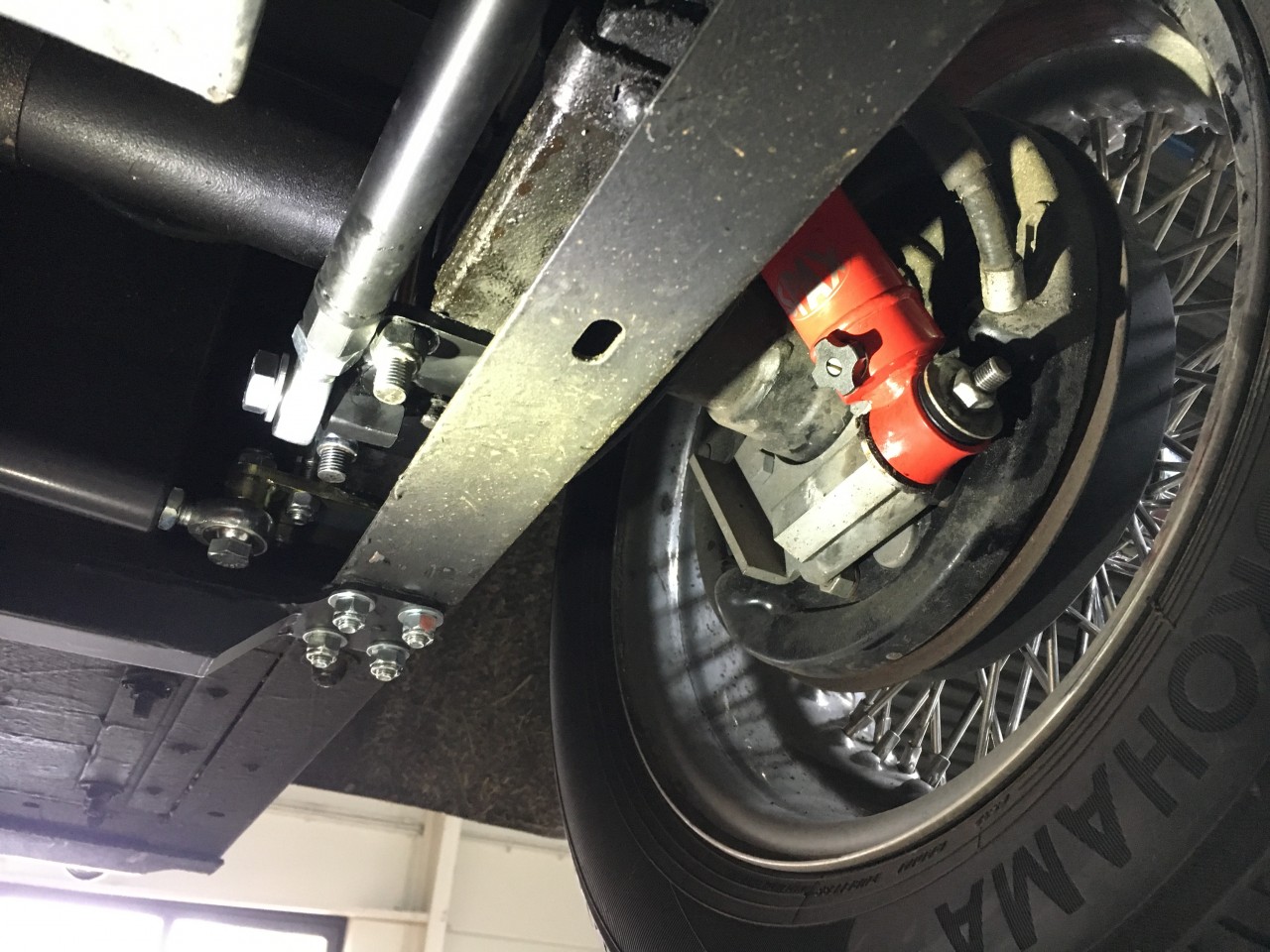

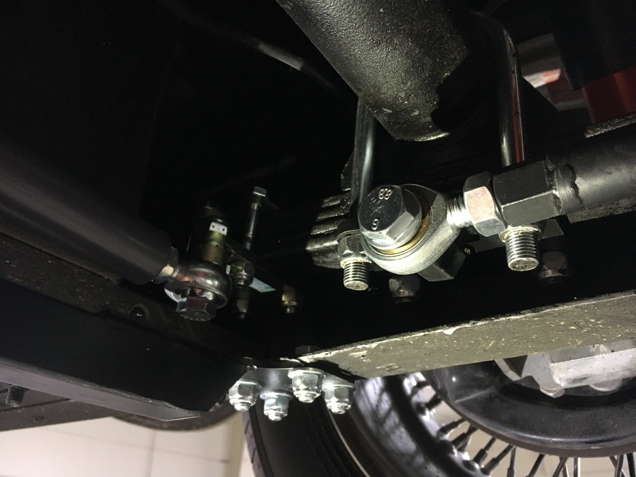

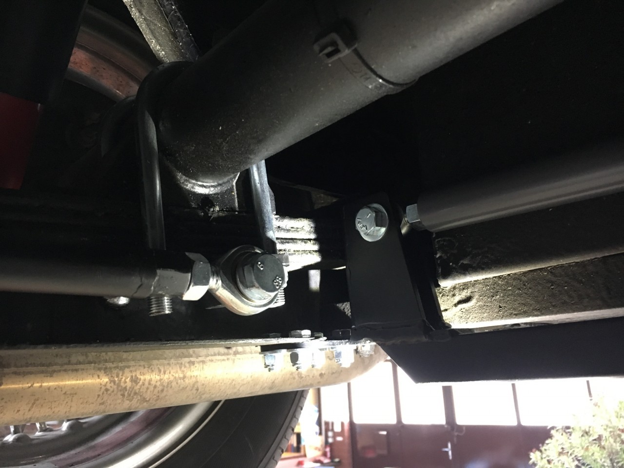

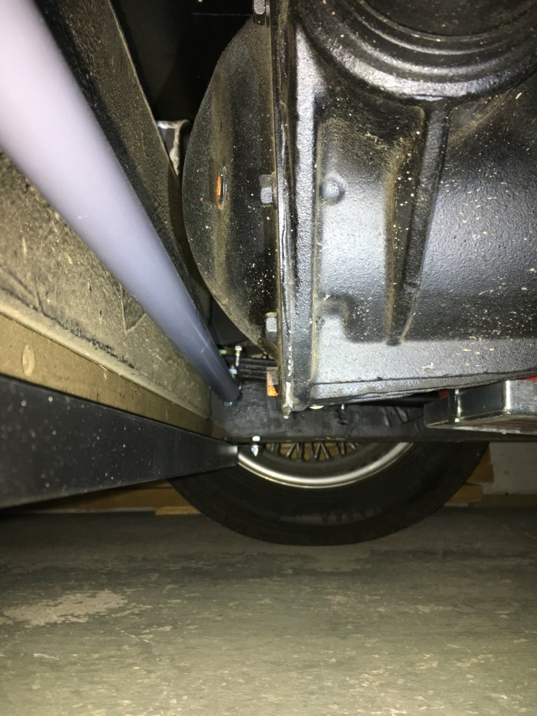

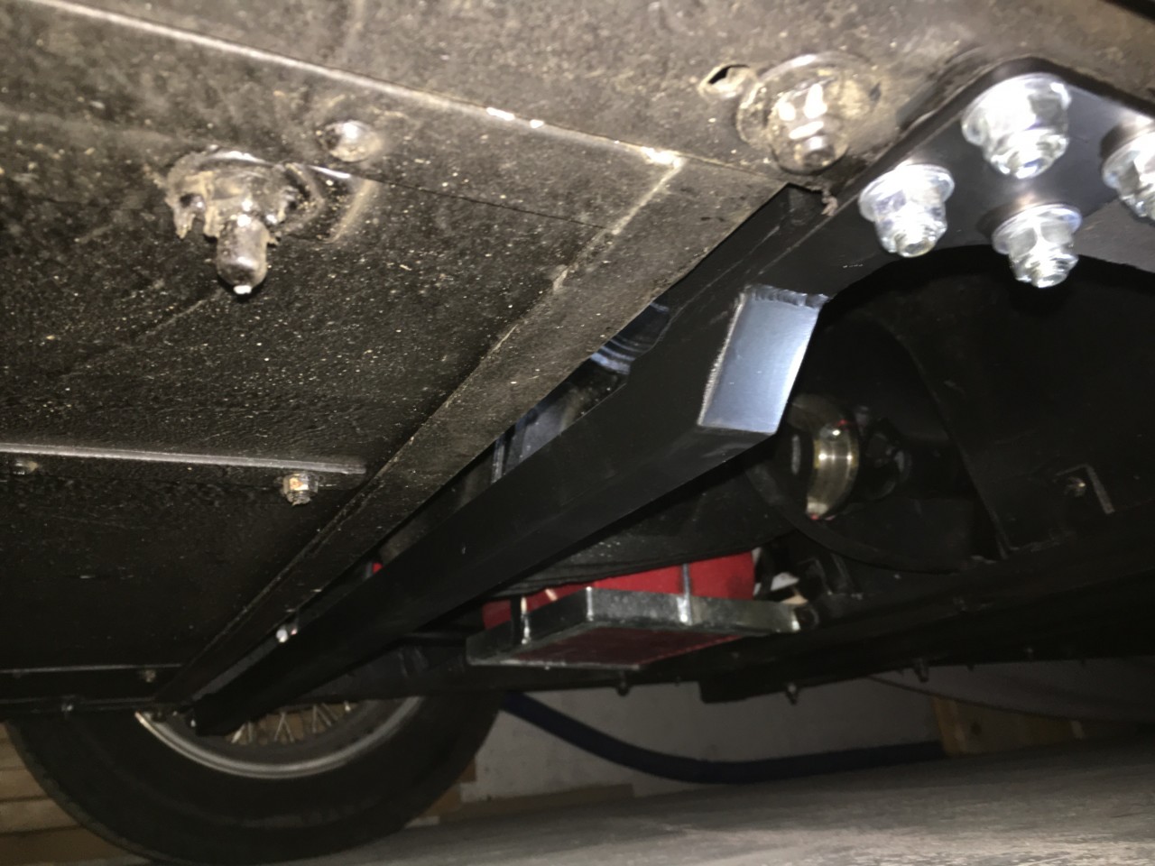

Last week some modifications were made to my Plus 4: the installation of a Panhard rod, anti tramp bars, brake reaction bars and adjustable shock absorbers. Here are some photos of the panhard rod. The space behind the differential is limited, but sufficient.
Whether they work, I can unfortunately only test next year, since I have the Plus 4 over the winter deregistered.

You should find less flexing & better road holding with the Panhard rod & the stays.
Let us know next year what you think.

Poor road holding, especially on uneven roads, were the trigger for the modifications. They were carried out by Morgan Austria. The people there used to tune cars for motor sports. After I have described my experiences to the road handling, the modifications took place on basis of their recommendations, to which I have fullest confidence. I'm very excited about the changed handling myself.
