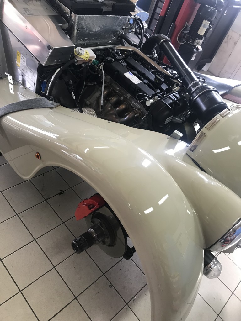

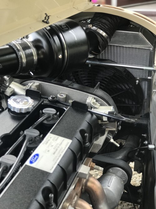

Craig great seeing the fitting of the ITG and air intake, notice its a metal scoop above the radiator, surely the metal scoop gets heated by the radiator, I think at parked /very slow speeds you'll be getting hot air into the induction?
Williams must have tested it? Do you have lagging on your exhausts as all that itg pipe work will store heat and serve to warm the air... until you get moving and colder air comes in?

I'm not sure about the metal scoop heating by the radiator, it certainly goes ok, so I'm sure Williams must have tested this.

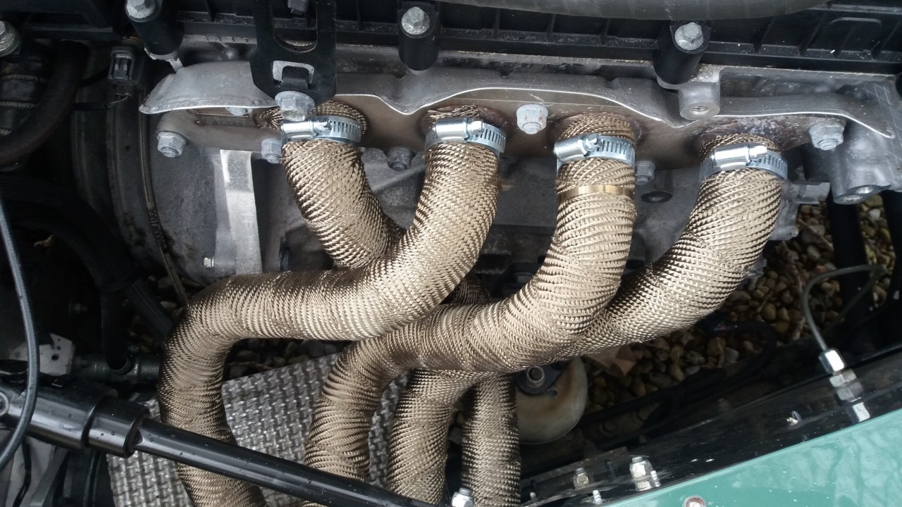

is this the lagging you are referring too / (image taken before new induction installed)

looks like no lagging on the manifold so it will heat up a bit.

Do you have a picture of the lagging on your +4 T16 Librands manifold?

Just for information..I used 58' of 2" lagging on my +4 Supersports
The jubilee clips were replaced with correct ss fasteners when all was in place
