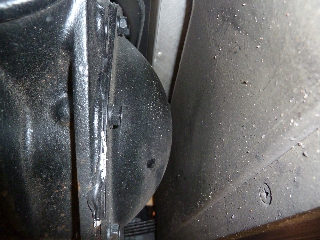

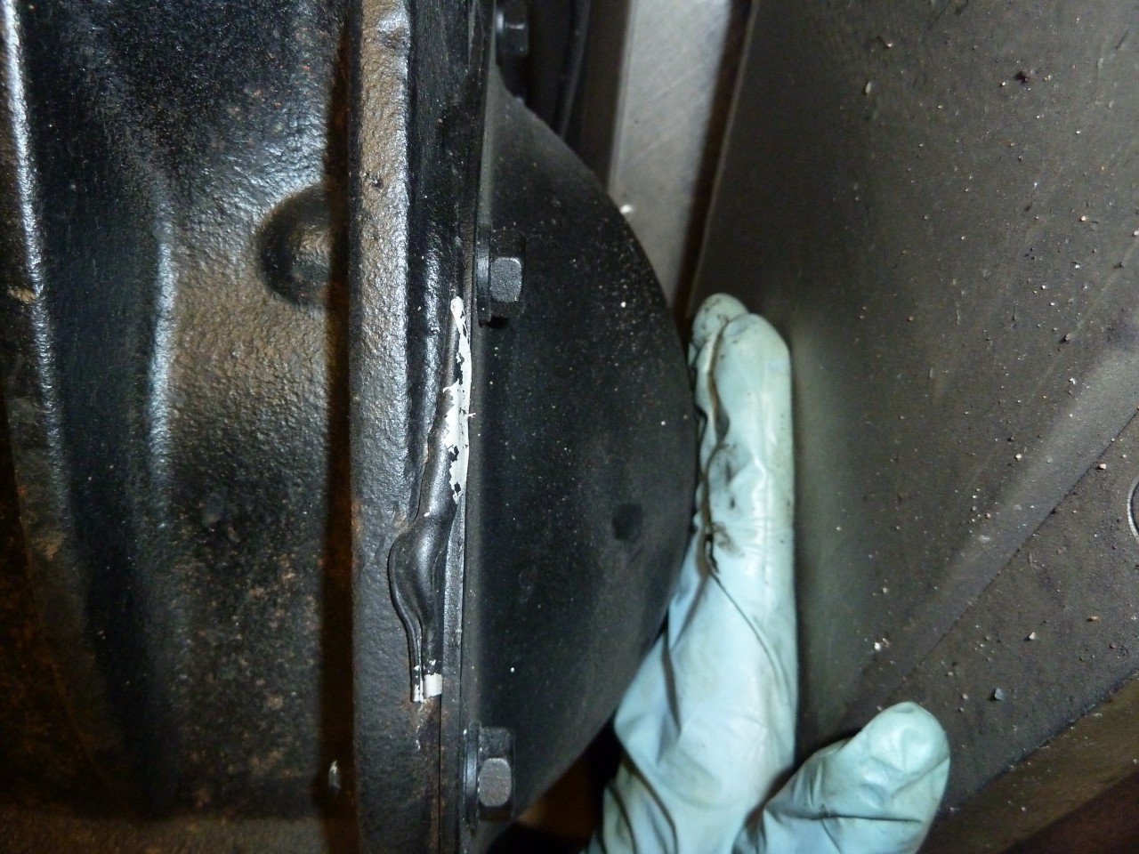

I took these photos earlier........and they show the tight clearance mentioned above. A Panhard rod could be made to fit, but will be very close to the diff cover and tank.
Note that the metal framed cradle arrangement was fitted to my 2012 Morgan, but the tank on the 2016 protrudes further forward than 2012. The 2005 arrangement is totally different with loads of space and I'll be fitting a Panhard Rod to my Roadster as soon as I get enough time!!

The panhard rod doesn't get anywhere near as high as the diff cover, so clearance isn't an issue. The panhard rod kit is bolted to the lower return on the chassis, and sits below the leaf springs
