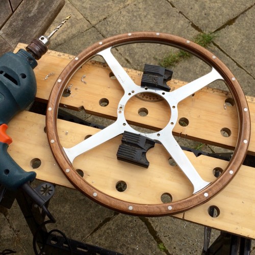

I just bought a standard 9 hole Moto Lita steering wheel and redrilled it for the 6 holes - quite straight forward really as the aluminium is nice and soft to drill
I’ll try and find the photos and post on here

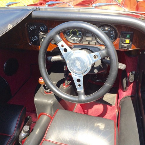

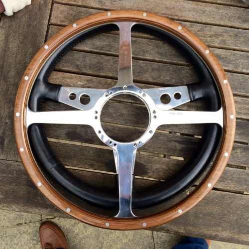

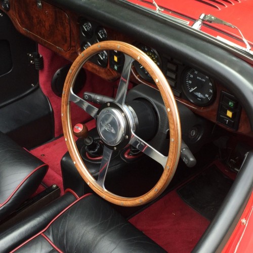

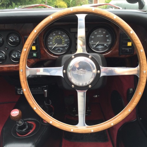

Here are the photos Rob
I started off with a leather offset but wanted a larger wood rimmed wheel so I just bought a new Moto Lita and redrilled it for the 6 hole boss then reused the old top ring - I sprayed my top ring black to give it a bit of contrast but regretted it as it chipped so keep it polished

Thank you for posting the photos Stewart. Interesting solution and nice wheel even if it does obscure the vertically positioned warning lights!
