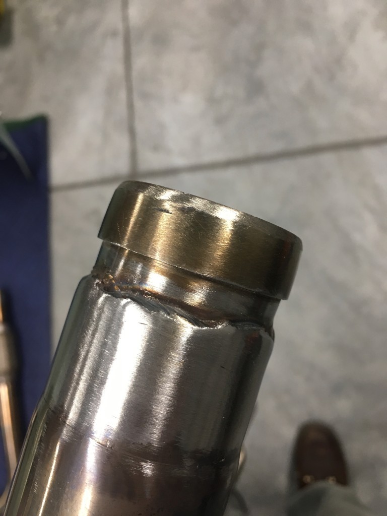

As for the exhaust stud nuts you can replaced them with a better design metal self locking 'jet nut' as used on aircraft. No need for the locking tab. They have the added benefit of only having a 3/8" hex (available in 6 or 12 point) which then allows use of a 3/8" socket with long extension.
Jet nuts installed. This was before I changed the pipe ends to a removable flange type as used on Harleys.
modified pipe end.
