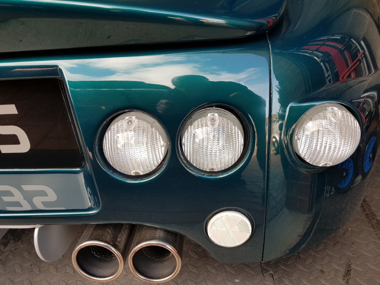

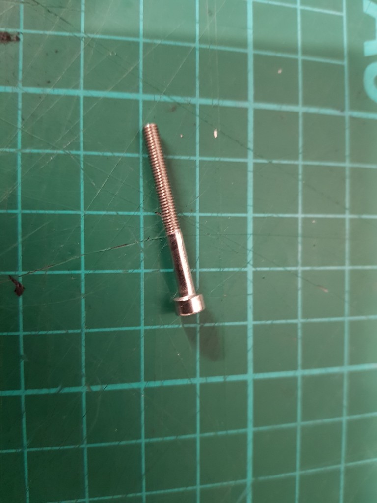

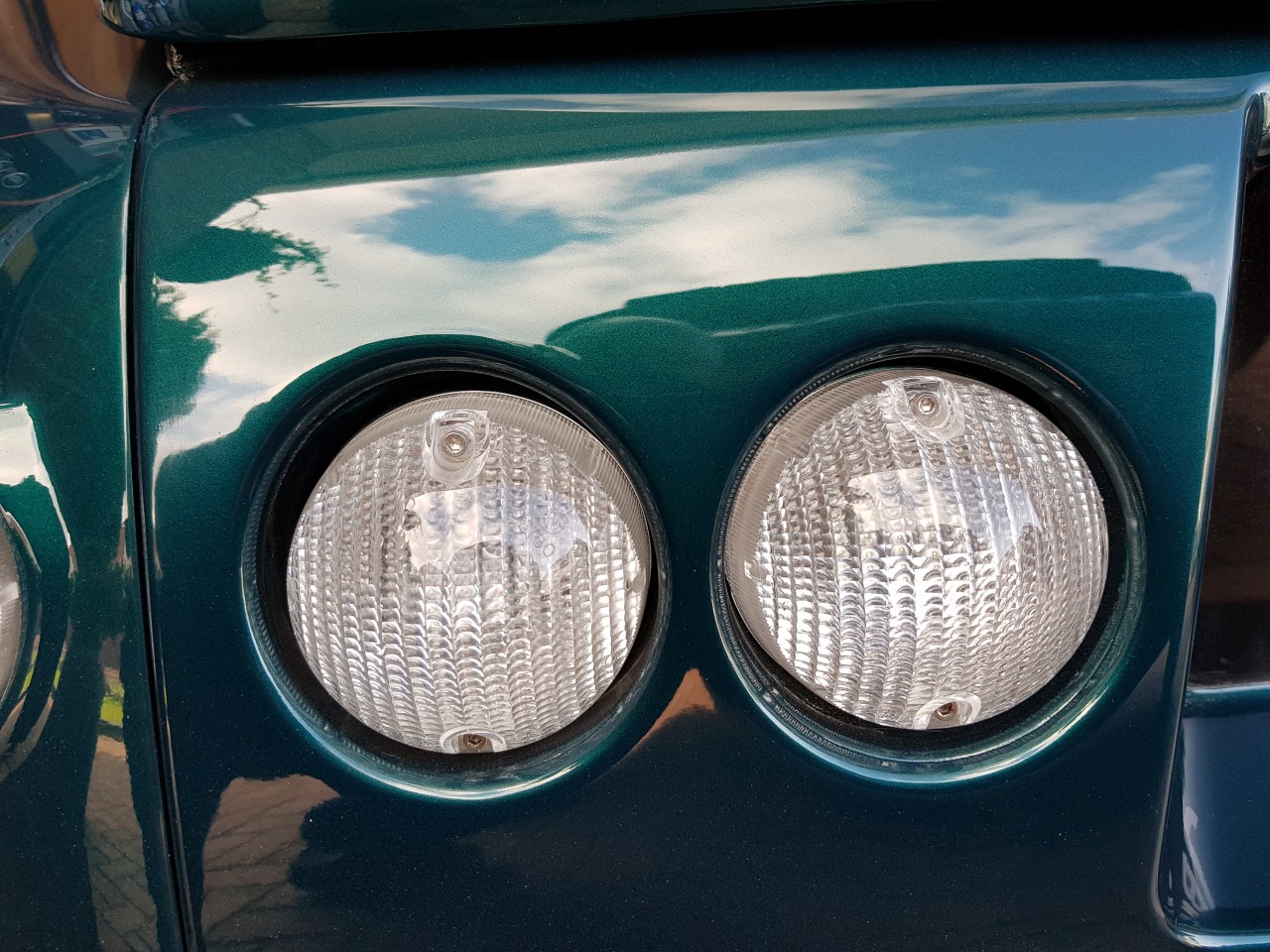

just so you (or I !) don't think I'm going doolally, pictures below of the M3 x 35, S/S bolts fitted to my clear lenses -
It may be that, as suggested, there are different metric/UNC versions in use ?
I also wondered, given how soft the brass 'top hat' fitting is, whether the new metric bolts cut their own thread....?
'tis a mystery...... sherlock
James

James, do your clear rear reflectors show red when illuminated by following headlights ?, as they do look neat

'afraid not Jon - but I do carry red ones which I can switch over and the Led's are very bright.
Not to everyone's choice I know....
