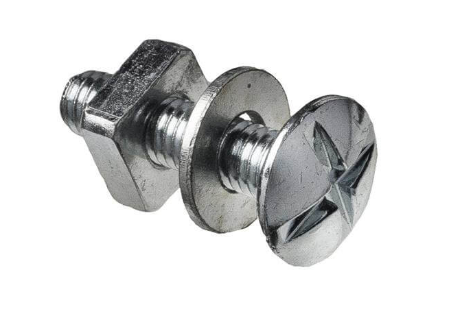

Yes, the factory mudguard needs careful fitting to ensure that the bolts do not interfere with either the boot liner or the tyre. The instruction leaflet makes it look easy, but I found that I couldn't just follow the diagram without running into those interference problems. In the end, I used low profile M6 ‘gutter bolts’ with the threads cut to 'just long enough' length to gain a little more clearance. Don't worry, I used nyloc nuts, not those horrid square ones.
The bolt heads may be fitted either on the inside or outside dependant on which side needs the most clearance. It's important to take your time and will involve some trial fits of the boot liner while lying underneath shining your torch on the critical area.

Bunny.. I am wondering if fender washers might help as well, in order to spread out the stress on the plastic parts?

Yes, they are good for that too. My old Ginetta (which had a fibreglass shell) was held together with gutter bolts for that very reason.
