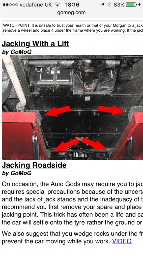

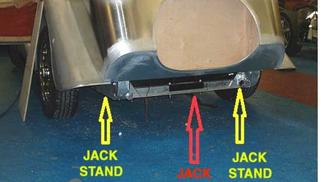

I jack here
Craig Jezz
Joined: Jun 2016
Posts: 288
SteveH Offline OP
Joined: Jun 2016
Posts: 288
Thanks for the info and the photos. Terrific !
